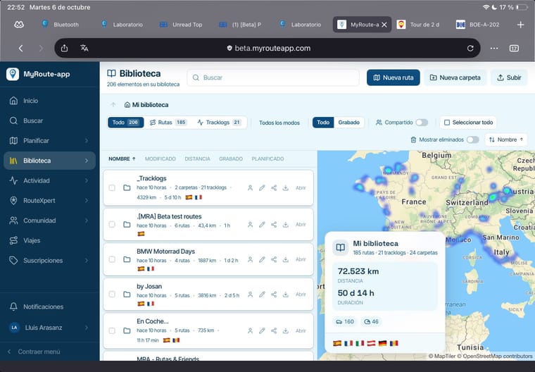

    Product has a fresh apperance and is very dinamyc… great job! It’s different from older planner but looks easy to use.
    I’m using the web via iPad, and I noted some issues:
    • In side menu options with submenus, like “community”, submenus are not shown and defaults data to first item of non show menu ( in same example, defaults to friends , so I can’t access to clubs or forum options)
    • Side option “Library” shows a heat map with routes (great!), but summary window covers more than a quarter of map space, so is not usable. Also map can’t be zoomed or moved

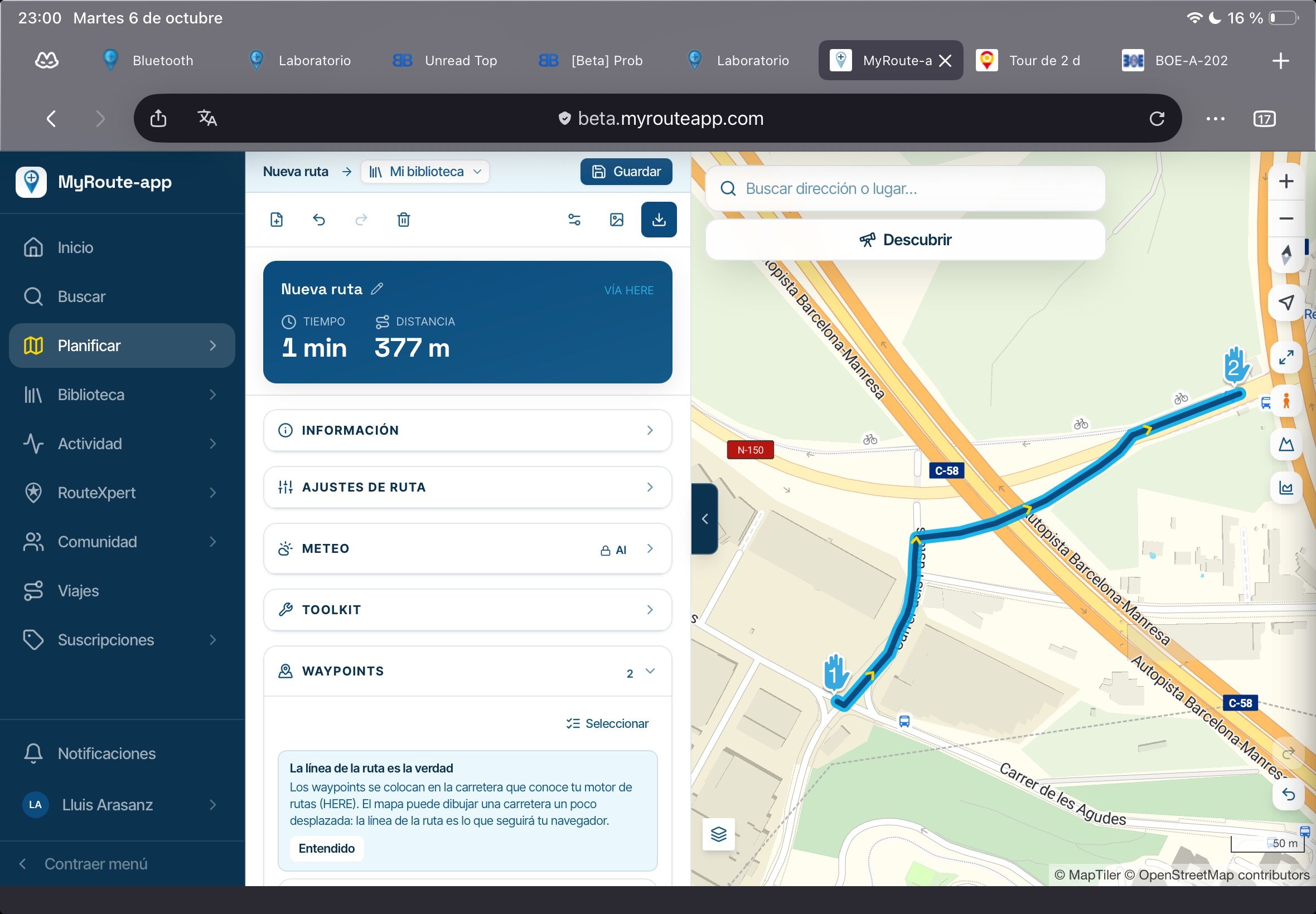

    • In planner window, overlay layers “street” has a lack of roads that are not shown. The route is over a street, but street layer is plain

        @Con-Hennekens
        Almost as easy as using a PC. I still have to test deeper.
        But first impression is good. Is better to config waypoints in landscape than portrait.
        And I noted that side submenu options are not shown on any option with ">". Heartmap on tablet can't be neither zoomed or moved and there is no options.
        I tested on Firefox and Safari, on both display modes: Desktop and mobile
        We continue....
