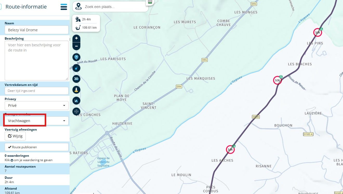

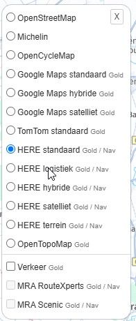

    @Travellexxie Maybe you were already using the HERE Logistics overlay map, the overlay map is remembered from your last route.
    #21
    @Nick-Carthew I opened the navigation app and also there these weight and length indicators are gone. So that would indicate that the camperprofile does not show these indicators, whether I use the web planner or the navigation app. But surprise surprise I made some screenshots during my trip. These were taken in the south of Portugal, with the camper profile on, on the 12th and 12th of April. In no way is there a layer with these weight and length indicators. So how would you explain that?
    • Travellexxie Travellexxie
      #22
      @Travellexxie Maybe you should be asking Corjan, I was merely making a suggestion trying to help you find a solution.
      • HABVEN aka MrMRA
        #23

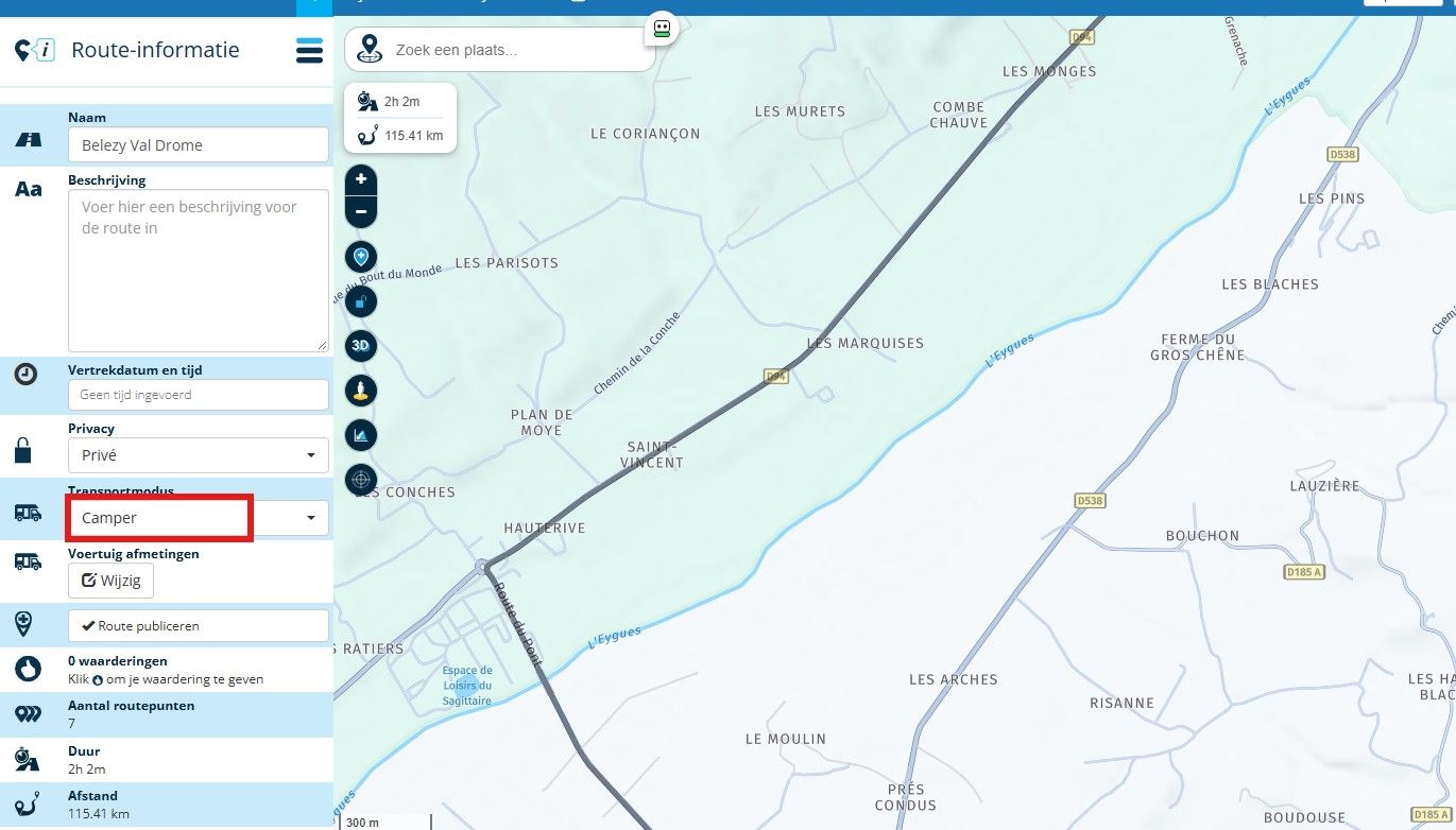

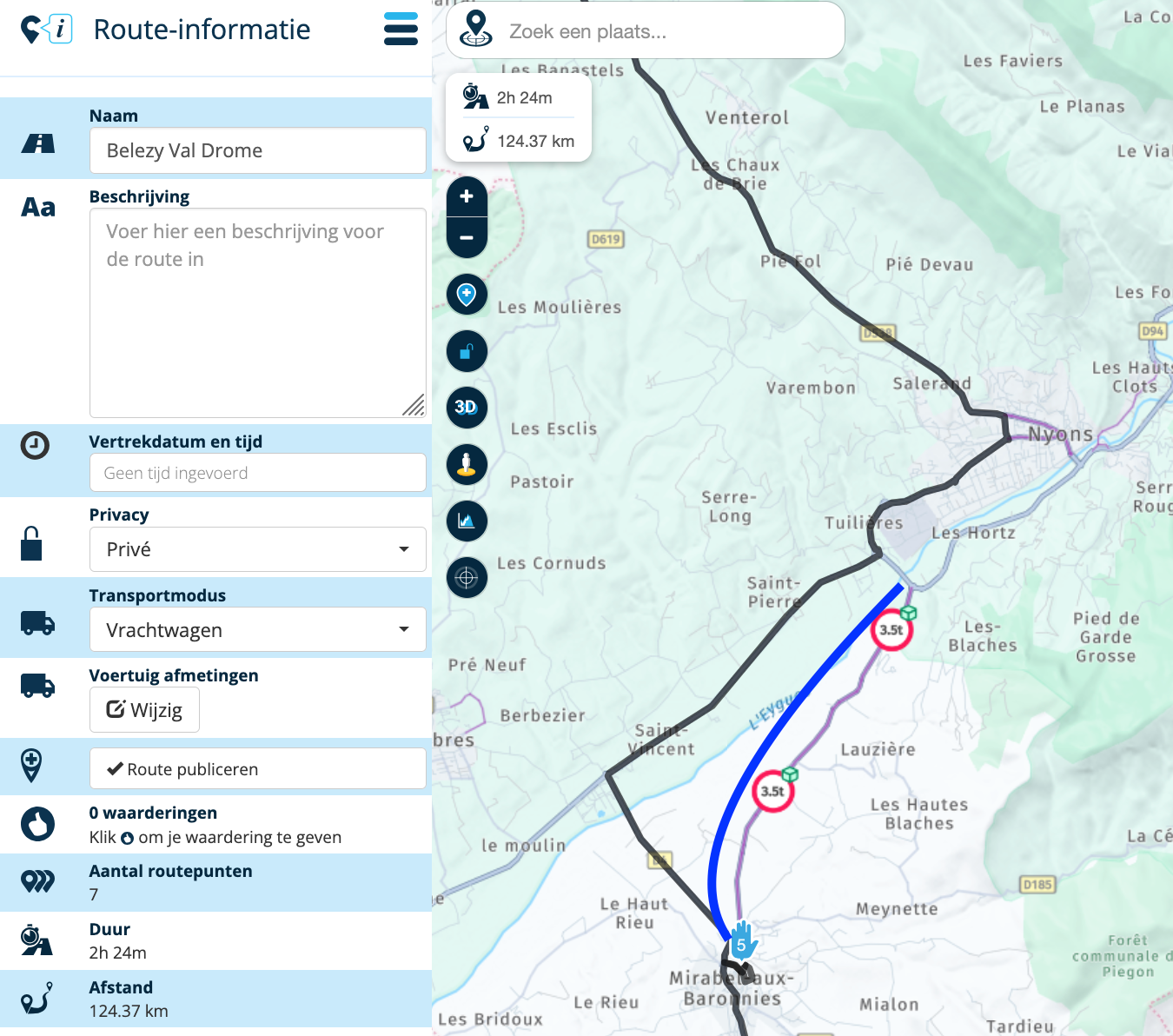

        Shortly after the introduction of the camper profile, I conducted a training session for the Camper Club Netherlands; at that time, the signs on the map became visible as soon as you selected the camper profile, meaning the logistics map layer was automatically loaded—just as it was with the truck profile.
          #24
          @Hans-van-de-Ven-MR.MRA thank you for the confirmation!
            #25
            Camper profile does not open the logistics layer since 2024-09-25.
            If we're still talking about the website.
              @Nick-Carthew no I didn't, I have used the camperprofile plenty of times during my 3 months travel through Spain and Portugal, The "weight-indicator" was there when I started this profile.
              Robineke
              Robineke
              Robineke
              #26
              @Travellexxie I can see your printscreens and both are in here-logistic mode as the maps are, except for signs, identical.
              As mentioned I have in both modes weight limitation signs. Funny, but not nice, you do not have it.
              I do not know how to resolve this except for deleting and new downloading of the app.

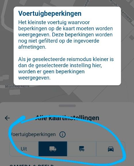

                Guys, In the mapsettings there is a setting for at what level you want restrictions to be shown. If you set that to truck, it will not be shown for campers.
                Robineke 2 Replies Last reply
                • MotoCon MotoCon
                  Robineke
                  Robineke
                  Robineke
                  #28
                  @Con-Hennekens thank you. extremely valuable contribution. Perfect👍

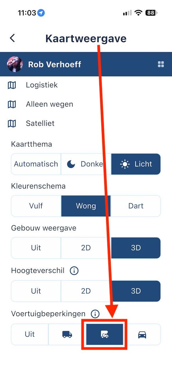

                          #32
                          @Robineke said:
                          hoe krijg ik het zo dat dit automatisch wordt overgenomen alvorens Navigeer te kiezen.
                          Het is een aanname van mij dat je ook met de beta (v6) navigeert? Dan vermoed ik dat je in dit het scherm nog niet hebt aangegeven dat de app altijd rekening moet houden met deze voertuigbeperkingen:
                          Robineke 1 Reply Last reply
                          • Rob Verhoeff Rob Verhoeff
                            Robineke
                            Robineke
                            Robineke
                            wrote on last edited by Robineke
                            #33
                            @Rob-Verhoeff ik heb inderdaad beta en weet, volgens mij precies waar ik de instelling moet doen, maar het wordt niet opgeslagen.
                            In mijn profiel staat Camper, bij het selecteren can de route zie ik het camper figuurtje staan.
                            Dan, net voordat ik navigeer selecteer, zie ik "Camper" als reismodus staan.
                            Dan klik ik navigeer en start. Dan de drie puntjes menu en kaartlaag aanklikken en dan staat er: Voertuigbeperking UIT.
                            Ik weet dan niet waar het fout gaat.
