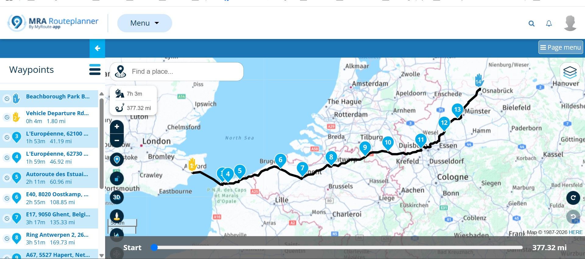

                          OK. So here's my original route, (377.32 miles) I hope it's public
                          https://www.myrouteapp.com/route/open/13569227

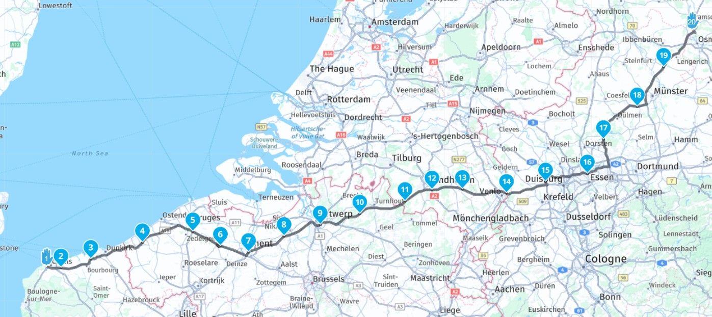

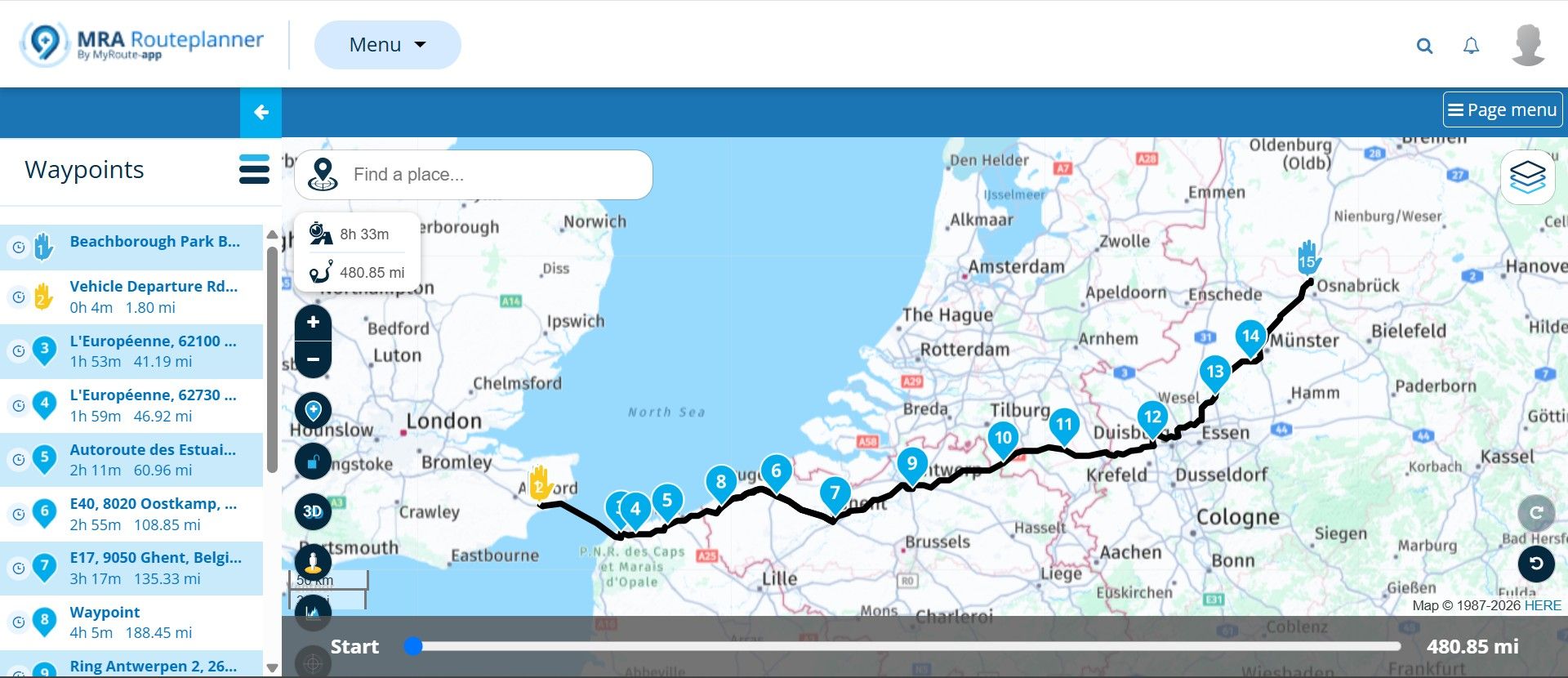

                          When I use expand to add just one more point (15, up from 14) it becomes 480.85 miles and point 8 has been added between poins 5 and 6, both of which are on the correct side of the road.

                            @Martin-Woodford try deleting the 2 points on the UK side of the channel then use the expand function
                            I think the ferry / tunnel maybe has something to do with the order / timing in this example getting really mixed up
                            after I did that then it was just the usual overpass errors

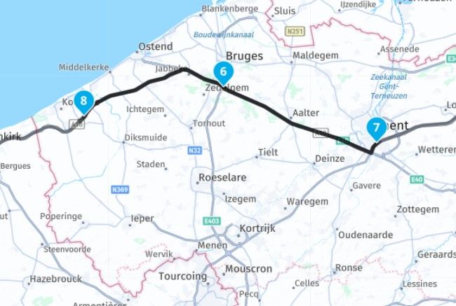

                                @Martin-Woodford The first impression on opening your route
                                You can see that the point 6, 7 and 8 are not in a logical order resulting in a dark black line as I suspected
                                next problem is indeed like @brian-mcg suspected the starting point on the other end off the tunnel / ferry witch resulted in the route being verry long. Deleting the first 2 points will result in the route being expanded like you want. In my case I expanded to 20 points.

                                      The new point number 8 can be identified as an MRA expand point because it's labelled "waypoint" the ones I manually placed have road numbers

                                        I don't see how "expanding a route in witch a tunnel or Ferry plays a roll, you"ll get strange results. So no mistake by MRA" can be the case. Why should a tunnel or ferry mean the results are strange ? I'm in Norway at the moment, there are hundreds of tunnels and ferries should I expect strange results everytime one is on my route ?
                                          The problem occurs when you expansie the route.
                                          In your original route you can see that the order of the shapingpoints is not logical. See my screenshot.
