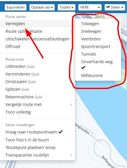

        @Mike-Luca-0
        From what i understand is, is that you want to avoid highway's and such?
        This can be done under the Toolkit menu.
        I am using the HERE map as default map due to the fact i'm using a Garmin Zumo XT as navigation device on 1 of my bikes beside the MRA Next app.
        You can select or deselect the following "obstacles":
        • Toll roads
        • Highway's
        • Ferries
        • Rail transportation
        • Tunnels
        • Unpaved roads
        • Environmental zone
        Screenshot below is in Dutch, but it gives you an idea were to look.
        Also, if you want to go from A to B (or as in your example, get as quick as possible away out the city and going to the good stuff) place a startpoint (waypoint) from were you want to start the route and place an end point at th elocation you want to go. If you set the options as shown in the screenshot correct, MRA routreplanner will create a route from A to B avoiding the items you checked.
