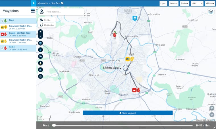

        Sorry @Corjan-Meijerink Screenshot of the route with Points 2 and 4 being the same place. I quite often meet up with people at a place, we then do a circular route back to the same place before I head home.

          Wow! That one is interesting actually.
          I understand why it happens and will make sure it's fixed in the definitive 5.1 release.
