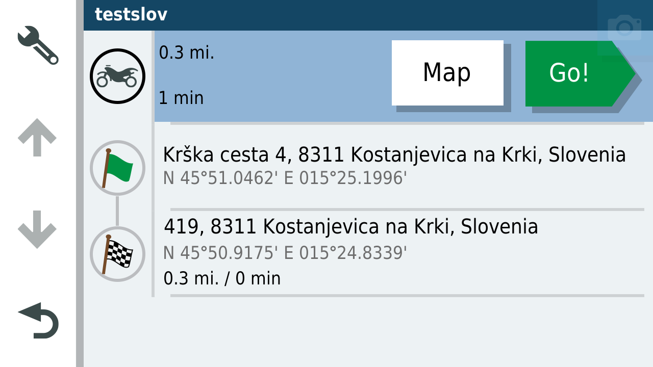

    Hello everybody. I am a gold MRA user and I use MRA to create routes in HERE maps and transfer them to my Garmin Zumo XT (using Garmin Drive and gpx 1.1 R/T/P).
    I noticed a weird behavior lately and I cannot understand what is going on. I first tried the Zumo XT forum, but couldn't get any real explanation there...
    Just to clarify, I have my Zumo XT updated all the time and I created the route in MRA freshly in the morning and drive the route few hours later on the same day.

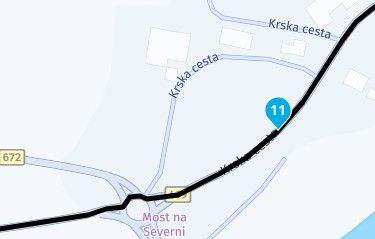

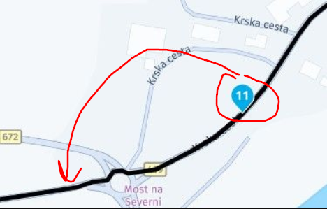

    This is how one part of the map looks on MRA - and this is exacly as I want it:

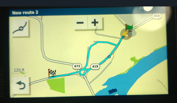

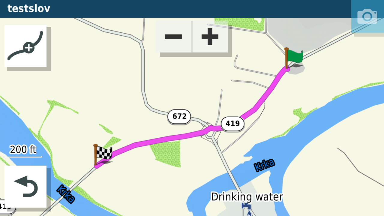

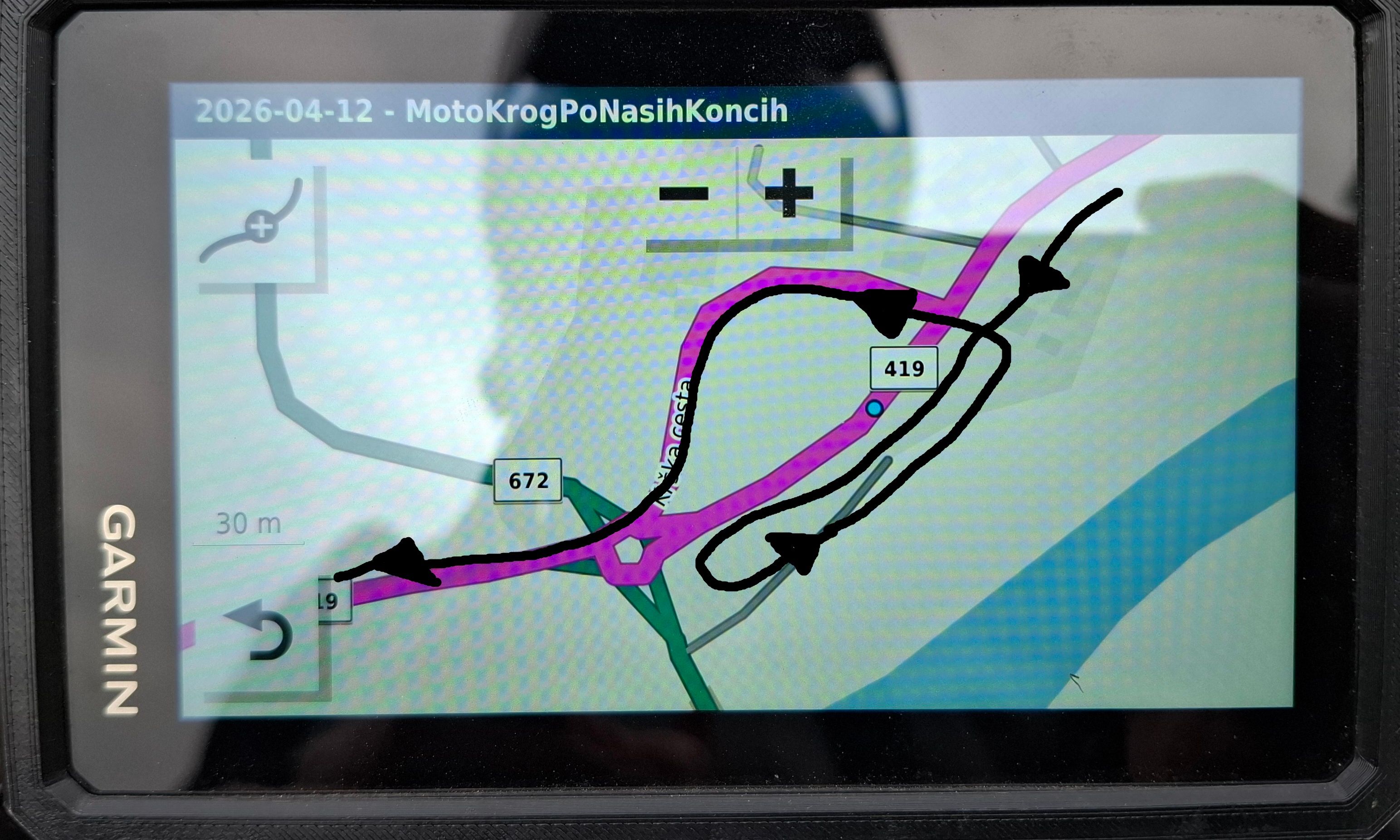

    This is how it looks in Zumo XT maps and the black arrows shows how XT wanted to navigate me through this section:

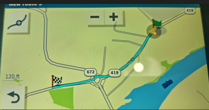

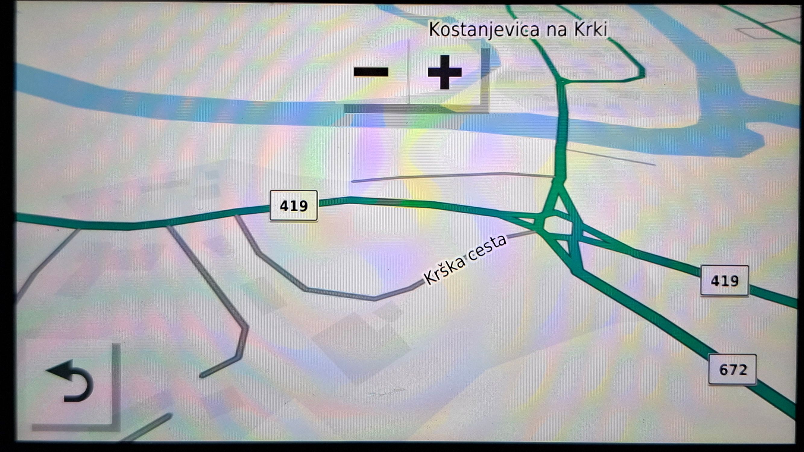

    What is weird though, this is the original map on my Zumo XT of this section, when I don't have navigation active (it has everything connected and it shows that Zumo XT knows which road is the main one):
    On the Zumo XT forum some suggested that I placed the shaping point in the wrong lane on the road, but from what I see this road doesn't have multiple lanes (not on MRA and not on Zumo XT)...
    I also checked my avoidance settings, but nothing helped there. Also MRA has the "shortest route" and Zumo XT also has "shortest route" selected.
    Any ideas on what I am doing wrong?
    It is not really a deal breaker, but it is really annoying and I get at least one of these on every trip...
    I thank you for your replies.

      It looks like your Zumo thinks a right turn is not allowed. It could be a map error on the Garmin map.
      Boštjan Kreutz 1 Reply Last reply

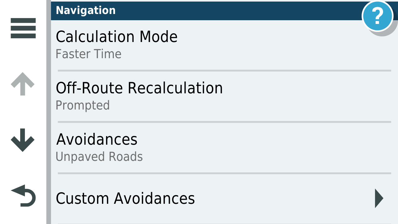

            @Boštjan-Kreutz
            It is recommended for XT users to turn off Automatic recalculation
            Most will have this turned on but i have notices (and read on other forums) that turning it off also avoids "crazy stuff".

              @Boštjan-Kreutz there may be slight differences in the maps from MRA & that you get from Garmin,
              the 2 companies update the maps at different intervals,
              but I do not think the map is the problem here,
              First I used a simple route with 2 points either side of the roundabout, just the start green flag & the finish chequered flag, the simple route on my Zumo XT was good & the simulated path taken was correct
              I then added a middle point before the roundabout in a similar location as shown in your picture
              My XT gave a crazy route similar to yours
              For the last test I just moved the middle point to the north side of the road & the route works correctly
              For me this is just another crazy case of the Zumo XT doing stupid routing & why people keep repeating that you have to place the points exactly on the road.
              This case proves even when the points look correct the XT will still get it wrong, it looks like it is trying to get to the little side road to the south towards the river
              MRA navigation is a lot more, a lot lot more tolerant of point placement
              Because of crazy stuff like this it is why I gave up on the Zumo & why it now sits in the bottom of a drawer
              As I have said many times, IMO the XT is a piece of $&!7
              (recalculate on/off makes no difference in this case)

                    Also I think I have a recalculation turn on, I have to check. I also don't quite understand how does device reacts when I turn this off, I have to read about it some more. Because I do want the XT to reroute me if I do some unplanned turn because of the sightseeing, road block, or whatever reason. That is why I also use shapping points (not only via) to easily skip them during route if need be.

                      Banned
                      @Boštjan-Kreutz said in Weird navigation MRA to Garmin Zumo XT:
                      I understand your doubt about the recaclulation turning off.
                      But the main reason to do this which is also suggested on other forums is that, if you have a route and you want to follow that route from A to B as it is ploted and as it is intended, you turn it off to avoid any deviations/reroutes/etc.
                      I get the point that you want to be able to take an unexpected turn somewhere to the left or to the right. But kep in mind that your device might direct you back to a waypoint that you skipped.

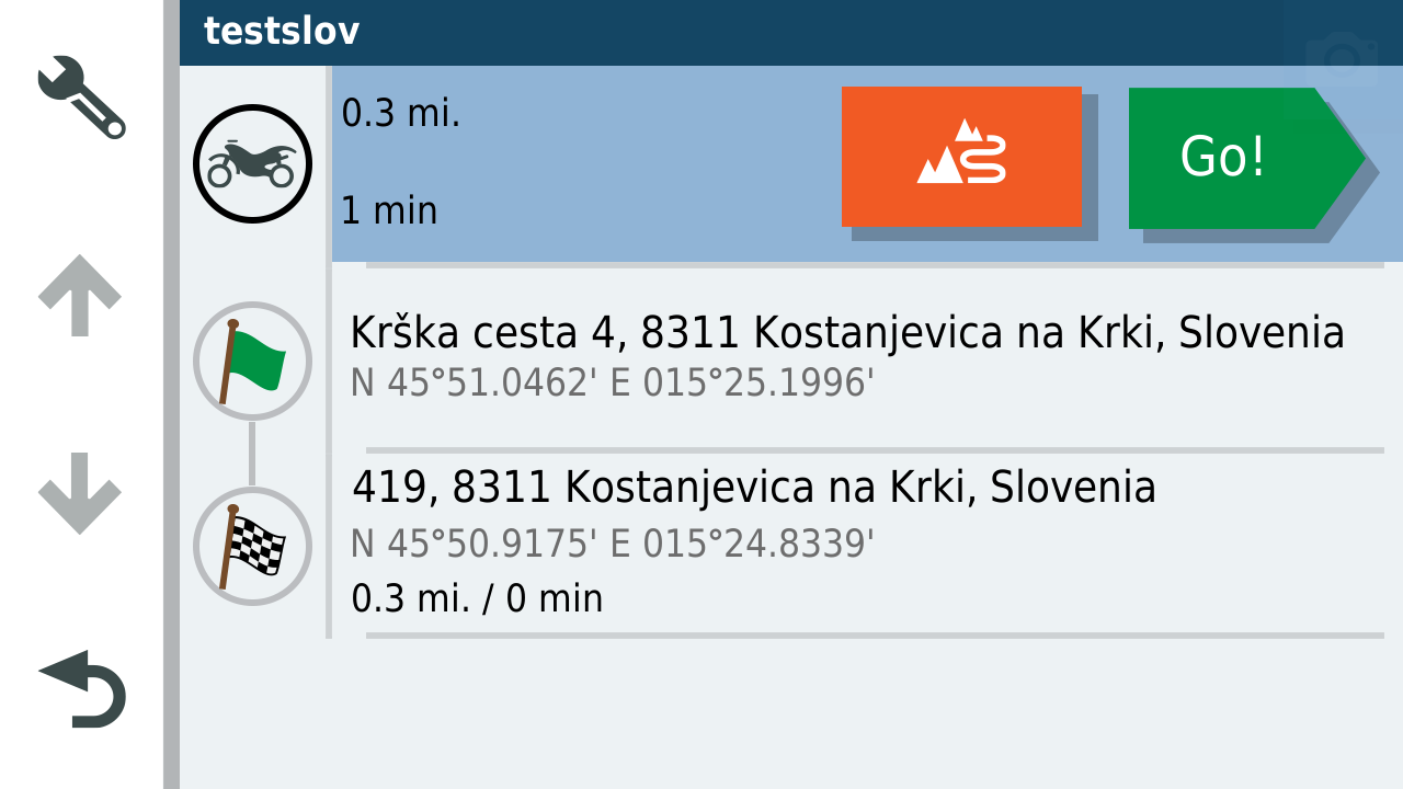

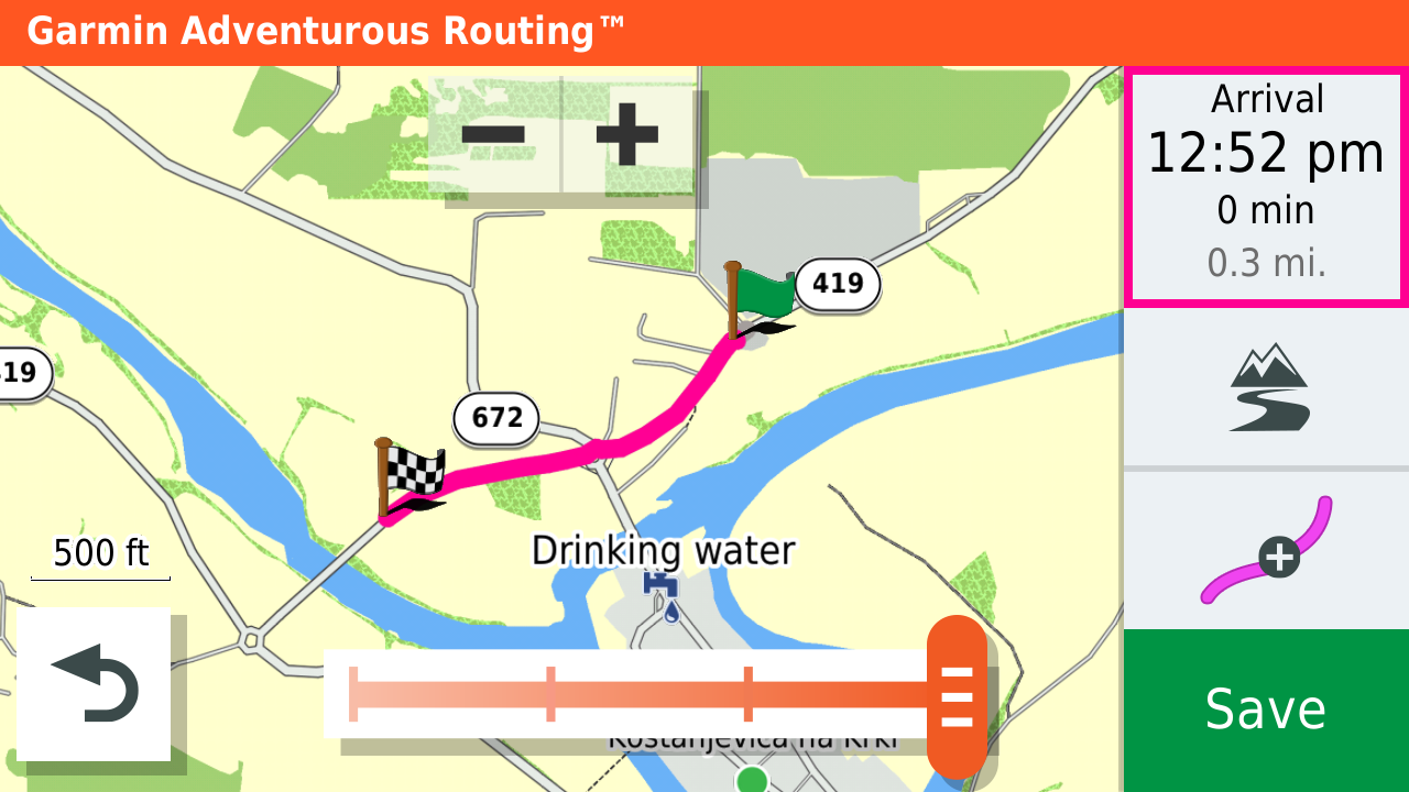

                      • Mzokk
                        I've tested this route on my XT and it works fine with no glitches.
                        My calculation mode is faster time.
                        When you open the route to navigate it looks like this.
                        If you set nav preferences to Garmin Adventurous Routing you get the little mountain box
                        When you press this before hitting go you can use the slider to make the route more wiggly.
                        I don't use it as it can bring you round housing estates and city streets and I prefer to put enough shaping points in to pin the route to the roads I want to be on. Could this have created your issue?

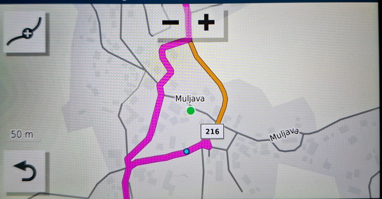

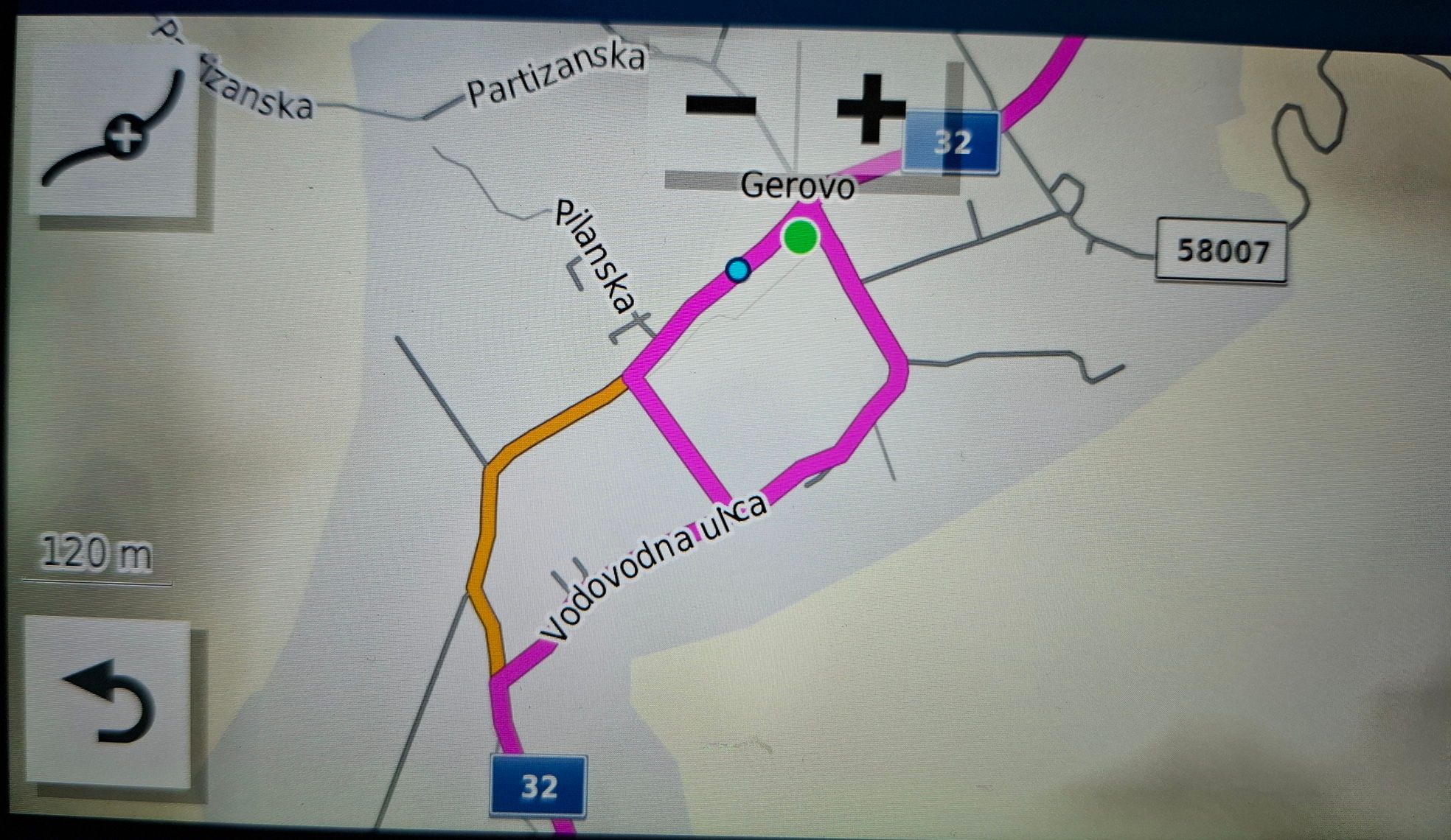

                        • Boštjan Kreutz
                          Boštjan Kreutz
                          Boštjan Kreutz
                          Thank you @Mzokk for taking you time to test. I am wondering if you would put another point in the middle of the route, where the sign 419 is on your image, would you get the same problem as me?
                          I am aware of the Adventurouse routing option, but I also didn't find the use of it. The idea is great and it is also one of the marketing reasons why I bought the Zumo XT, but in reality - as you said - it rarely discover new twisty roads in my area. In reality it actual drives me through the private/estate roads and city traffic.

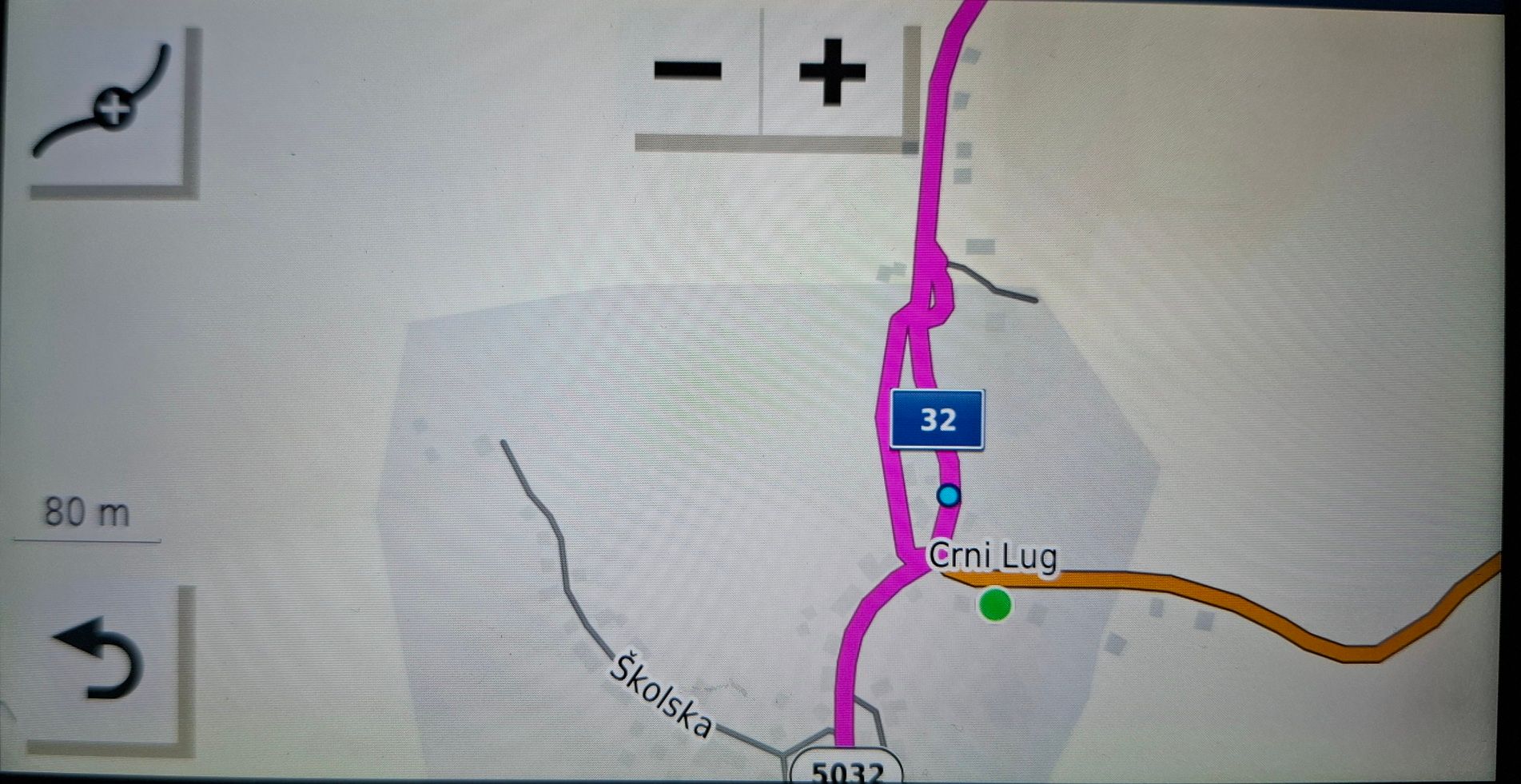

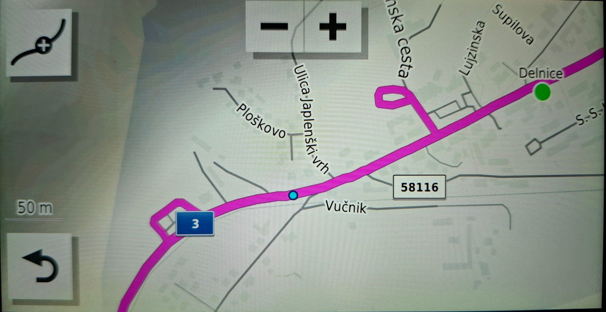

                          Anyhow, I dig up some more of the other similar cases I got - all these are just from the last two rides 🙂 And non of these has a roundabout or two lanes road.

                                  It doesn't let me go back to a previous point, like it would for a hard waypoint, it just goes crazy on every point and then goes further on the correct route.
                                  If i stop the route and start again halfway, it does the same thing.
                                  It doesn't send me back to the beginning either.
                                  I have been working with Garmin since the gps 12 and the streetpilot III. This is a first for me to discover such weird things.
                                  Recalculation ON is what MRA suggests, and worked perfect before, so what happened here i don't know, setting it to OFF might work, but that looks like a workaround to me, not a solution.
                                  Even stranger that the XT of my girlfriend didn't have this issue. In about 2 weeks we have a roundtrip, about 170 km's, will see what happens there.
                                  For now, i just don't know how to reproduce or resolve it.
