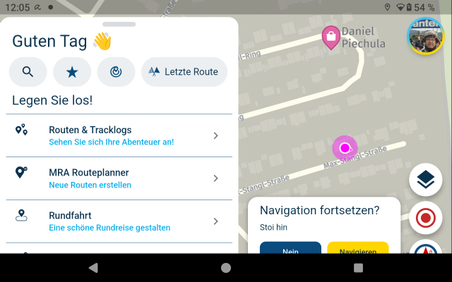

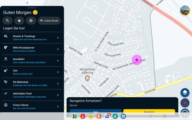

    Since Version 5.x of MyRouteApp Navigation Next, I have been having difficulty ending navigation:
    If I'm going to stop a navigation, there comes a first popup with question: "Stop navigation" with button "comfirm". This is in top area of the screen, and I can press button "confirm" also with gloves.
    After confirming, the main screen appears, with a second popup question: "Resume navigation?" with buttons "no" and "navigate".
    • Why question twice?
    • Regardless, of whether you have used full-screen moder in settings, or not - the second qestion "Resume navigation" with buttons will be covered by device bottom menue:
    Check with Samsung Galaxy Tab S8 (Android 16) in landscape format:
    Check with DMD T865-X (Android 14) in landscape format:
    For both devices, if they are used in portrait format - ther is no issue:
    Please move question boxes up, so, the device bottom menue will not cover it, and users can hit the buttons securely, also with gloves.

            @Guzzist in my T865X I’ve selected to not use the full screen mode for MRA. Then the buttons are acceseble
              Hi, I tried on my Oukitel the settings with full screen and without. And on both, the buttons are accessible.

                wrote on last edited by Guzzist
                @Corjan-Meijerink said in Unable to stop navigation:
                @Guzzist you have a specific Android setting enabled which causes this.
                found it: it's about the display size and font size in the system.
                Because I'm a bit more then 20 Years old, I purchased the DMD T865-X because of the bigger screen. Unfortunatelly, the technic nerds of developer paired the bigger screen with higher resolution. So, my hope for bigger text (more easy to read during a ride) remained unfulfilled.
                The only solution for me was then, to increase text size in system.
                Now, I need to play arround to find a balance between font size and uncovered buttons by system base menue line. 🙄 😠
                But there are dynamic behaviors in the app:
                • unfortunatelly, if I don't use full screen view, the text box "Resume navigation?" with buttons "no" and "navigate" will still be covered by device bottom menue!
                  But if I dont answer this question (I could not answer because of covering), but escape, close the app and restart the app - the last screen with unanswered question about "Resume navigation" appears immediately after the app starts - but *now this textbox with question is above the device bottom menue and uncovered!
                • If I have used "Full screen mode" in the app settings, I get the full screen. But if I stop the navigation, just then the full screen is no longer visible - now the system button bar is visible. And this covers the question box "Resume navigation?" with buttons "no" and "navigate" again!
                Edit: No font size or display size setting made it possible to see the text field with the question box "Resume navigation?" without it being covered.
