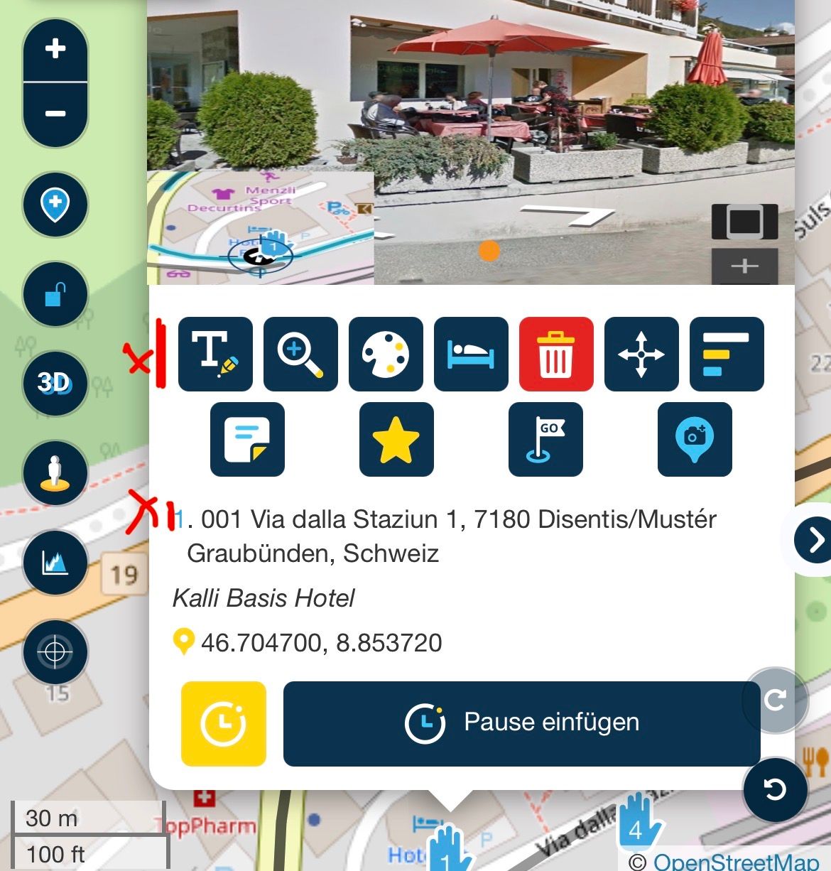

                • Jörgenundefined Jörgen
                  Exactly, place your last WP under favourites and it is available next day as startpoint.
                  @Jörgen said in Waypoints - copy request:
                  Learned something again... because the favorites are always available.
                  But only the basic text under 1.) is taken over, where the street name is written, etc.
                  The note is not saved in the favorite, just as an image is not transferred...
