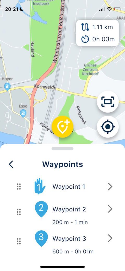

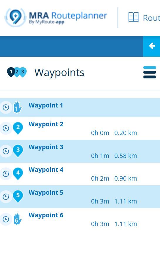

    @Martin-Wilcke said in MRA running on DMD:
    99% of these misunderstandings come from the different usage of "waypoint" in MRA versus DMD/GPX.
    Do you care to explain this difference? What does a waypoint do different in DMD than what it does in MRA? In the end they just shape a route. I think most difference are (just like with any native device) caused by routing settings not being equal between the planner and the device (or DMD software in this case). The beauty of MRA is (amongst others) that a native MRA route applies the planner settings on the navigation app.

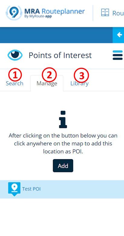

        @Guzzist
        Excellent summary!
        I agree with you 100%, both in terms of the facts and your assessments.
        I want to add something about POIs, as they can also easily be confused with DMD2.
        In the MRA POI area, we see three tabs, and it is essential to understand that these POIs have different contexts.
        #1 and #3 are like libraries; #1 "search" contains the POIs from the map, and #3 "library" is a private library. These POIs are not directly related to the route but are, so to speak, above it. These libraries also exist in DMD2, one via "search" for the map POIs, and the other via "myLocations" for the private library.
        #2 "manage," on the other hand, contains the POIs that are actually assigned to the route, and only these are included in the GPX file as <wpt> when exported.
        So if you want to transfer MRA POIs to DMD2 (where they are called waypoints), you have to insert them in tab #3.

          @Con-Hennekens said in MRA running on DMD:
          Sorry mate, no. We had a long debate on this topic, which I don't want to start over again.
          Please take a look at @Guzzist 's excellent summary, where he explains in detail why the term “waypoint” has different meanings in MRA and DMD2/GPX.

                  @Martin-Wilcke ... hi Martin, I'm so sorry about, but that's not 1000% correct 🕵
                  It's so important to talk with correct wording...
                  If you open a route in MRA (no matter if a new, or existing one), than you can add POI.
                  • by selecting a category from in MRA existing POI list in tab "search"
                  • or by activating/selecting a imported POI list in tab "Library"
                    then (if you zoom in the map) you will see many POI about the selected category(s)
                    then you can click on one or several of those just visible POIs in map, to make them "embedded" in the map -> will be included in an exported gpx file as <wpt>. case#1
                    and/or you can make them really as route point -> will be included in an exported gpx file as <rtept>. case#2
                    if you check both checkboxes in the dialog, you will get a route point and a POI. Icons are laying then on each other in map, may you can't see both.
                  • or by creating a POI on the fly by using tab "Manage", clicking button "Add", paning the map and entering so manually a location as POI in the map case#1
                  • If you close this route and reopen again, the entered POIs case#1 are still visible - on map and on POI list "Manage" in MRA.
