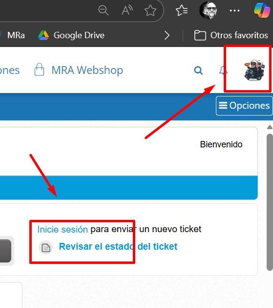

    @Corjan-Meijerink Hi, I'm sending you the log files by email. I can't open a ticket.

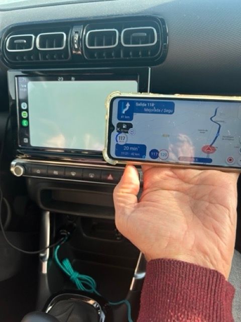

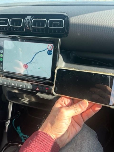

                • Car Side displays map, but no indications, but freezed and phone side app is "black". photo of this:

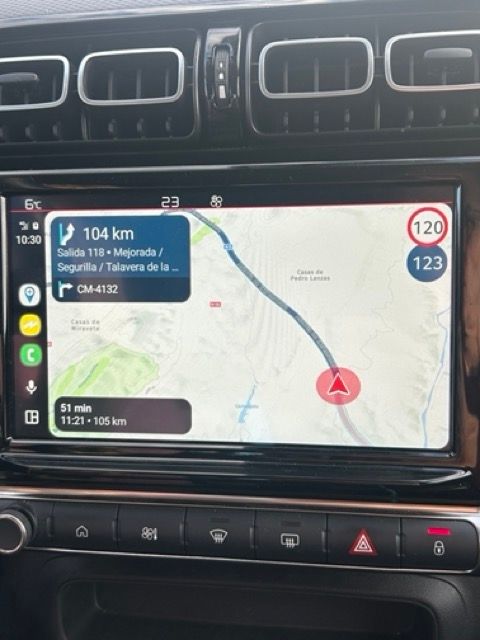

              • I do not know in which point I'm going: No number , no indications, nothing on CP/AA screen, even when there are space for that:
                The space between 22nd indication" and "time to next point" i perfect for that
                Also, an icon on "time to next point" indicating next viapoint, next stop or end of route will be useful.

                  • Car Side lost map. There are some indications on screen, but no route path, no map, no voice indications. On phone, is normal:
