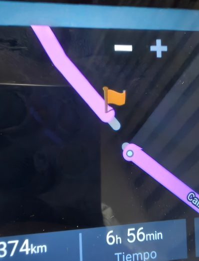

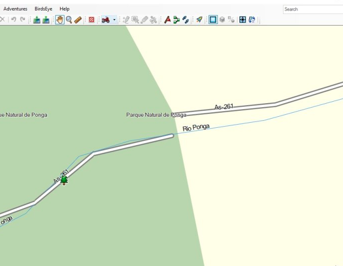

    I dont know if this was posted yet. I searched for it but couldn't find it.
    I have a route where a road appears incomplete on the map (HERE), and the planner makes me backtrack many kilometers to go to the same place and continue the route. If I try it with another map, it works fine, but when I transfer it to the Garmin XT2, since it has the same map, it recalculates and makes the same error. Is there any way to "cross" that point in a straight line?
    I've attached an image.

          Thank you so much for your reply.
          I already did this and it works in the route planner, but when I import it into the GPS, it does the same thing again and looks for another route (150km) to get to point four.

            @Juan-Carlos-Garcia-Ojeda if it’s a map error, report it to Here. Like that it will be a solution for both MRA and your XT
            • Juan Carlos Garcia Ojeda Offline
              Yes, I'll have to report it. I think it would be a good idea to be able to connect the points on the GPS as well.
              Thanks

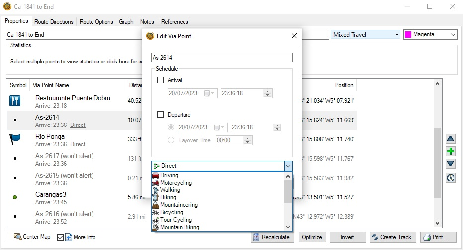

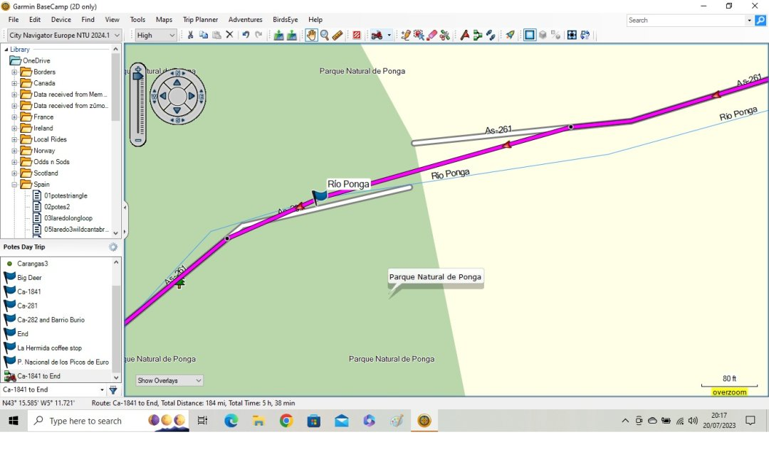

                    Mzokk Offline
                    Mzokk Offline
                    @Juan-Carlos-Garcia-Ojeda I've had this before on here maps in Spain (Picos)
                    You can fix it in Basecamp by designating two waypoints as "Direct" across the gap.
                    Change the point type to direct and calculate the route. Keep the rest with the motorcycling profile. I've tried this out and the route executes. If you make the points "don't alert" you don't notice the route has a patch/repair. Hopefully this is useful.
                      Hi
                      I did it in Basecamp and it seems to work
                      Thank for answer.
