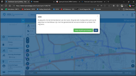

    when using the opencycle map in order to create a bike route I encounter very often a problem in the wense that the "HERE" map blocks the route...
    I try to use the F3 bike highway beteween Velten and Herent (part of the Leuven-Brussels F3), and encounter each time this issue. Strange that teh cycle map is using the HERE map basis for calculations. I have had this problem so many times that for me this opencycle map is useless. If you want more examples, let me know

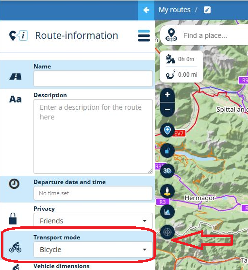

      Are you using the planning map from OpenStreetMap and do you have bicycle selected as transport mode?

        Yes,

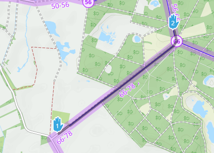

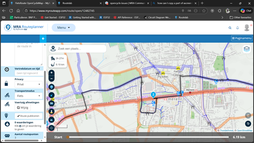

        When I force a routing point on the F3 Bike Highway by drag and drop I get the following:

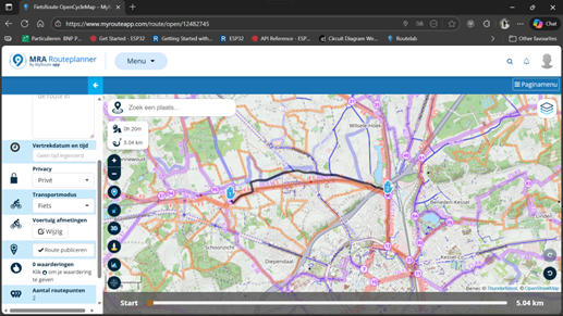

        Then, when I place two routing points on the F3:

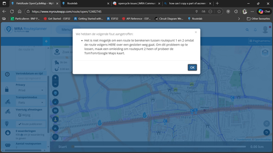

        When hitting "help me ...":

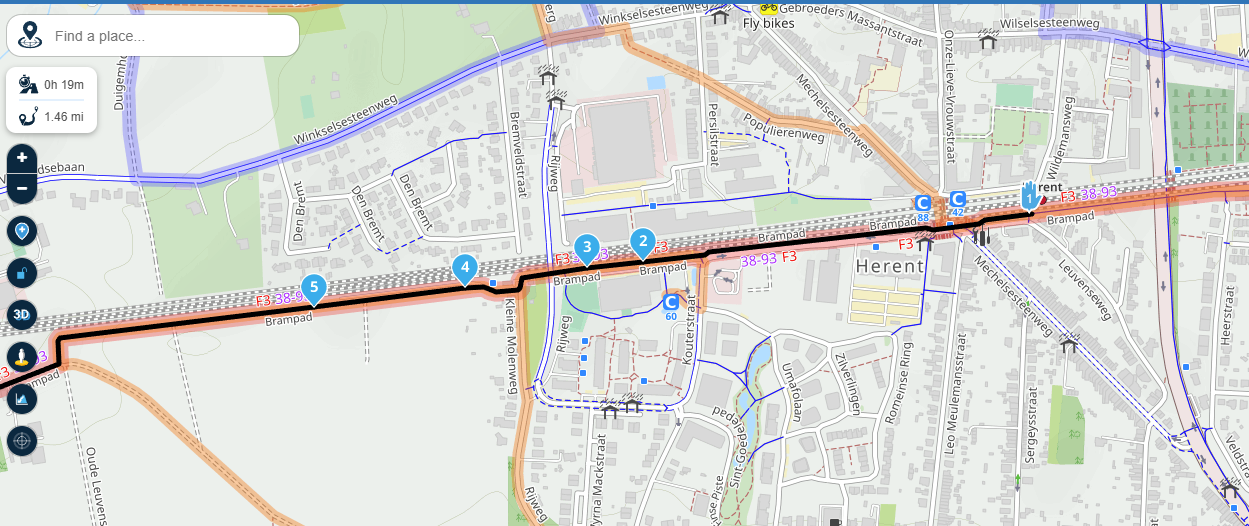

          @Mylle Just add more route points and you can cycle on F3.
          • Mylle
            Mylle
            Mylle
            ??? i wil try that, but isn’t the message ( the last one ) not misleading in this case?
            Danny
            • Mylle Mylle
              Danny
              @Mylle I don’t know, I couldn’t read it.

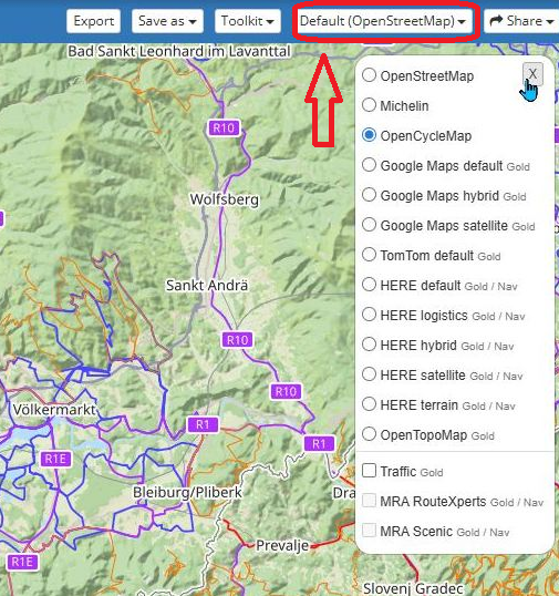

                  @Rolf-Engelsman, change your base map to OpenSTreetMap, and your transport method to bicycle:
