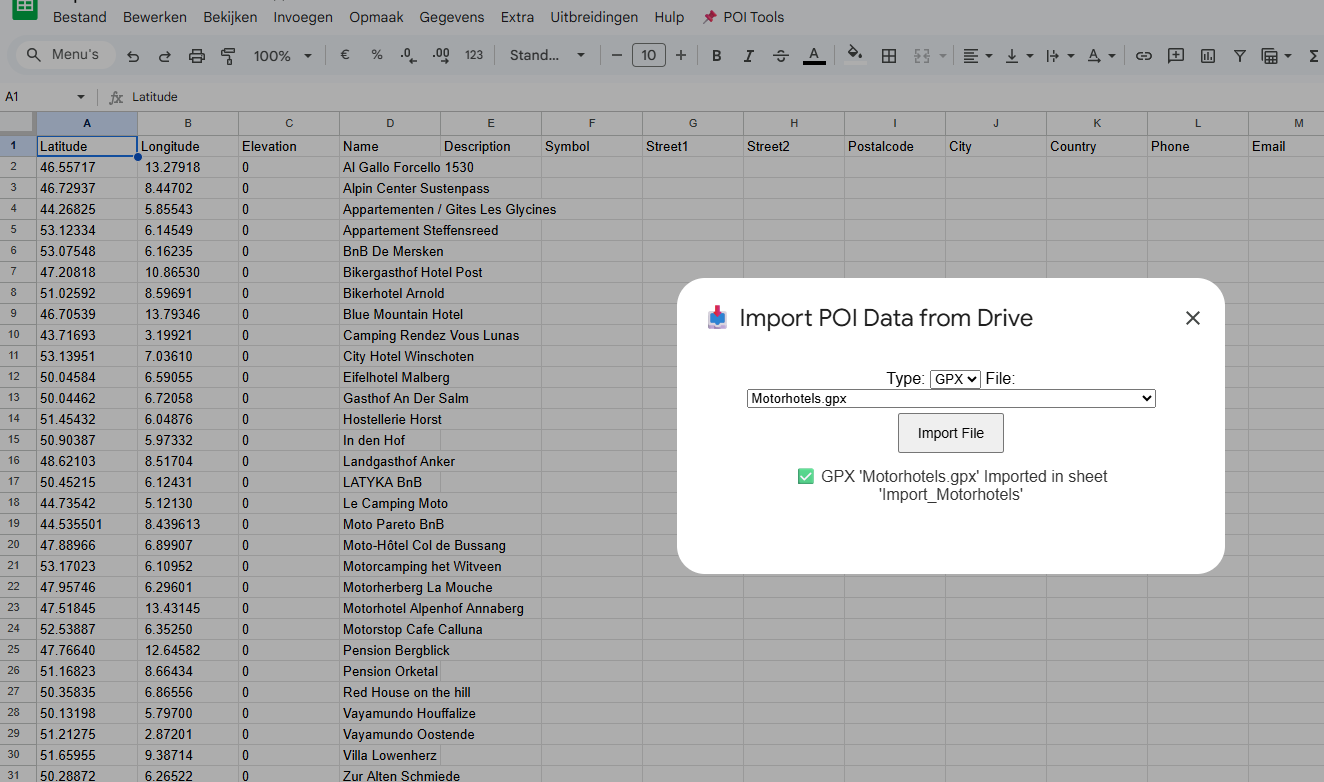

    Imported file

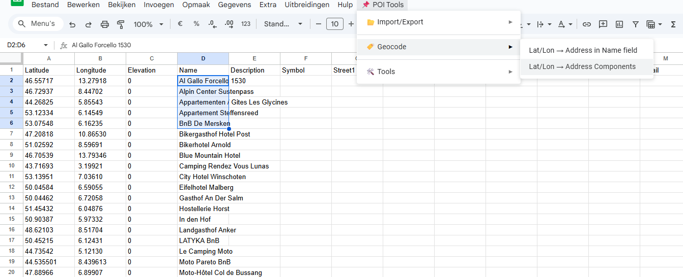

    file menu

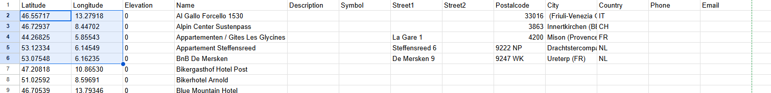

    Geocode the first 5 rows by selecting Latitude and Longitude

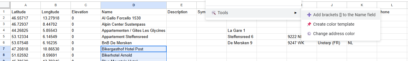

    "Special MRA tools" to fill in address in the Name field.

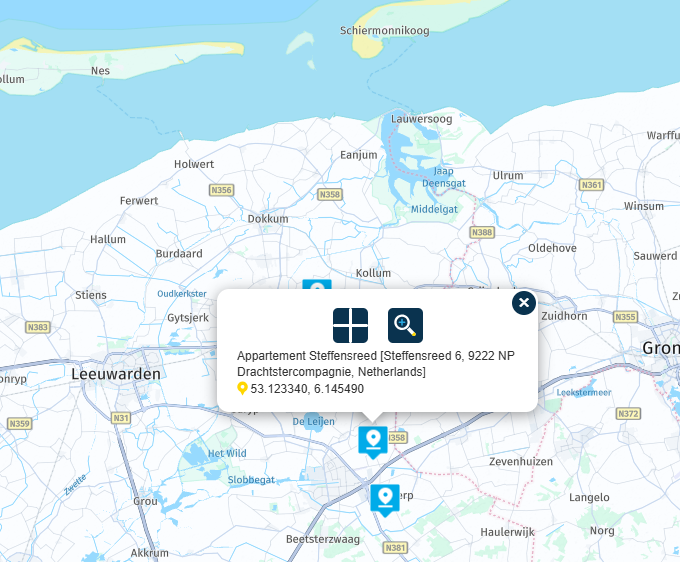

    POI GPX imported in MRA where in the Namefield the address is added between brackets.
