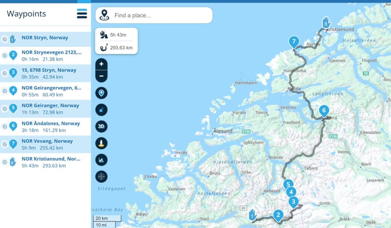

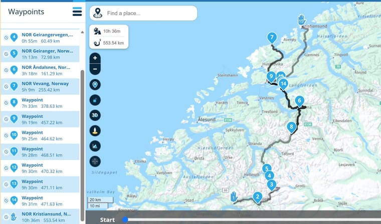

                            I also find the Expand feature to be extremely frustrating at times. Here's an example where I created a 293.63km route with 8 waypoints. I currently export my routes to my Garmin 595 so want to Expand the route to include some extra shaping points. I Expand the route to 15 points total and the new route goes from 293.63km to 553.54km!!!! Note that my original points are all in the correct order.
                            I sure hope that this feature can both be retained and improved in the new planner as when it works it can be very useful.
