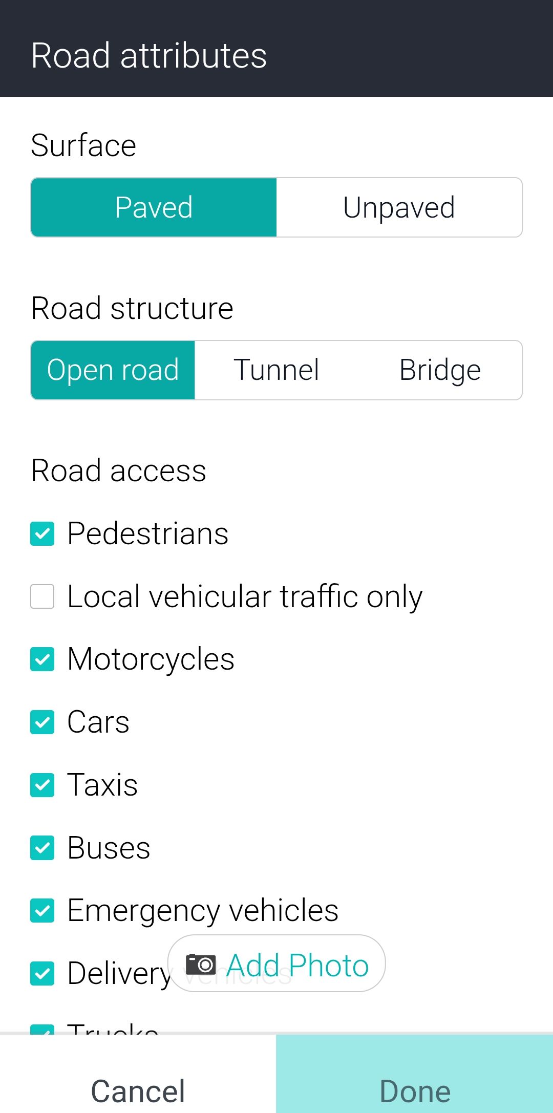

            i have noticed that gravel/unpaved roads in HERE are often marked as paved in the area where I live. So in these cases the problem would still be there, but it would be a map problem and not mra's fault.
            You can use the "Map Creator" app to check and report map issues.
