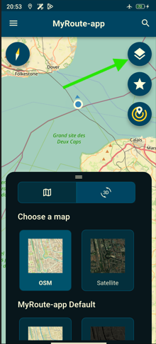

        Hi @Johannes-Bergmark if you are explicitly asking about the map layer in the navigation app (the green arrow)
        As far as I understand it makes no difference to the navigation which map layer you use
        The map layers in the navigation app are purely a graphic layer so you pick the one that most pleases you
        I also tend to use the OSM as it has more contrasting colours & I find it easier to read,
        the Here map is just a bland indecipherable grey mush
