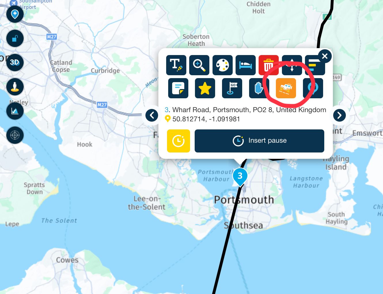

    How do I get the system to map for sea crossings such as Santander to Portsmouth ?

      Try this:
      https://www.myrouteapp.com/en/social/route/11051821?mode=share
      Klick on Point 3 and use the circled symbol.
      Kindly regards
      Reinhard

        @John-B-1 That's perfectly fine. In fact, there's an even neater way than the one above! In the Toolkit menu, choose Route Optimization > Shortest.
        See example: https://www.myrouteapp.com/en/social/route/11844951?mode=share

          The use of toolkit-options alters the whole route with unforeseen changes.
          Especially when the route is used on other devices than MRA.
          Reinhard's solution ist without side-effect.
          RT

            @John-B-1 Why do you need to include the ferry crossing, the captain of the ferry knows which way to go 😊

              @Nick-Carthew Because I want to show it on my Map.

                @Reinhard-32 Many thanks. Have done. It works.
