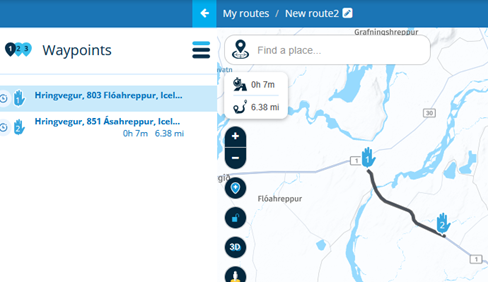

          1. create a new route in the web planner with 2 points, name the route “New Route2” because it has 2 points

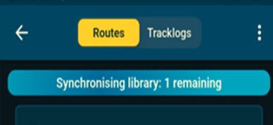

          3. select the Routes & Tracklogs button & the blue sync bar appears “Synchronising Library : 1 remaining”
            212a791a-2387-4c80-a4e8-0f9d04fcd76f-image.png 5971a58b-8e19-47ca-be15-36c4b7ad71df-image.png

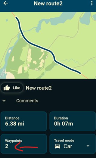

          4. all is good, New route2 is synced & when I select the route it has the correct number of points

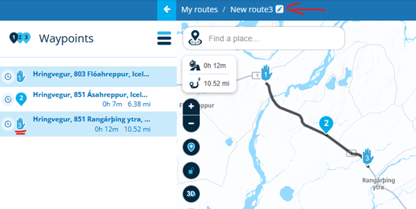

          6. On the web planner open the route “New route2” & add an extra point to the route, the route now has 3 points
          7. At the same time edit the name of the route, change it too “New route3” to show that it now has 3 points (this is not necessary but it helps illustrate the problem)

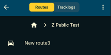

          8. close the web planner & go to the mobile app on the device, the device is online

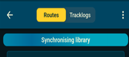

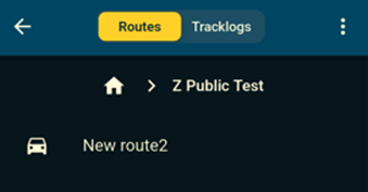

          9. select the Routes & Tracklogs button & the blue sync bar appears “Synchronising Library”. Note it does not say “1 remaining”
            cca5931e-a7df-44bc-886f-79df7be402a7-image.png 357f2ef5-0015-4085-aa99-b8aab4cebf9b-image.png

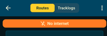

          12. take the device offline i.e. disconnect it from the internet / turn wifi off / put it in airplane mode

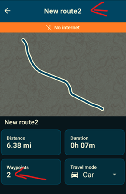

          13. go to the mobile app on the device, the device is offline, select the Routes & Tracklogs button
          14. a synchronisation is not possible because the device is offline as shown by the orange bar “No internet”
          15. Select the route “New route3”
          16. & surprise what do you see!
          This is supposed to be a route called “New route3” but when it is selected it shows the name of the route is “New Route2” & it only has 2 points
          It is the old original route, the route & it’s data has not been synchronised,
          all that was synchronised is the name of the file "New route3" in the routes list

                Interesting, I have found that apparently a synchronization of a route planned on the web, only takes place with the app when you click on "Routes & Tracklogs" in the app and then the symbol synchronize appears (text in blue)...
                It's not enough to open the app, I wouldn't have known until yesterday.
                Conclusion:
                Before offline you have to open the app where wifi or a mobile network is and go to the level that shows "Routes & Tracklogs". Only then does a synchronization take place...
                Recommended for the developers:
                • Sync in the background
                This does not happen automatically in the background, but that might be recommended.
                @Marinus-van-Deudekom
                @Brian-McG
                Interessant, ich habe festgestellt das scheinbar ein Synchronisieren einer im Web geplanten Route, erst dann mit der App erfolgt wenn man in der App auf „Routen & Tracklogs“ klickt und dann erscheint erst das synchronisieren Symbol (Text in blau)…
                Es reicht nicht die App zu öffnen, hätte ich auch bis gestern nicht gewusst.
                Fazit:
                Vor Offline muss man die App öffnen da wo Wlan oder ein Mobil Netz ist und in die Ebene gehen die „Routen & Tracklogs“ zeigt. Erst dann erfolgt ein Synchronisieren…
                Empfehlenswert für die Entwickler:
                • Synchronisieren im Hintergrund
                Dieses erfolgt nicht automatisch im Hintergrund, das wäre vielleicht aber sicher zu empfehlen.
                wrote on last edited by Marinus van Deudekom
                @Hubert-Thoring the moment I open the app a popup shows new routes have been synced
                When you click on routes aan extra sync is being performed
                  May be different between iOS and Android
                  iPad 9. Gen iOS 26.7.1/ iPhone 16e iOS 26.7.1/ Navi iPhone Xr iOS 18.7.10 / PC mit MS Win11 /❗️MyRoute-App im Cradel und Remotek-One❗️ Info zu MRA & Remotek One
                  Brian McG 1 Reply Last reply
                  • Hubert Thoring Hubert Thoring
                    I think I may have discovered the cause of the Sync Bug described above
                    In this post https://forum.myrouteapp.com/post/68014 - I describe how when using the UK location/timezone the time stamps on the routes are a bit messed up, it is impossible to get them correct for the UK & the sorting in the mobile app comes out wrong
                    It also appears that the cause of the sync bug described above is due to the web planner & using the UK timezone
                    In the web planner if I set my timezone location to Europe I do not get the above sync error
                    To me the problem is not with the mobile app or the sync, it is the web planner timezone function that has a bug is messing things up
                    So if you are in the UK & use the UK timezone it is possible your routes will not be correctly synced unless you edit them in the mobile app before going offline
