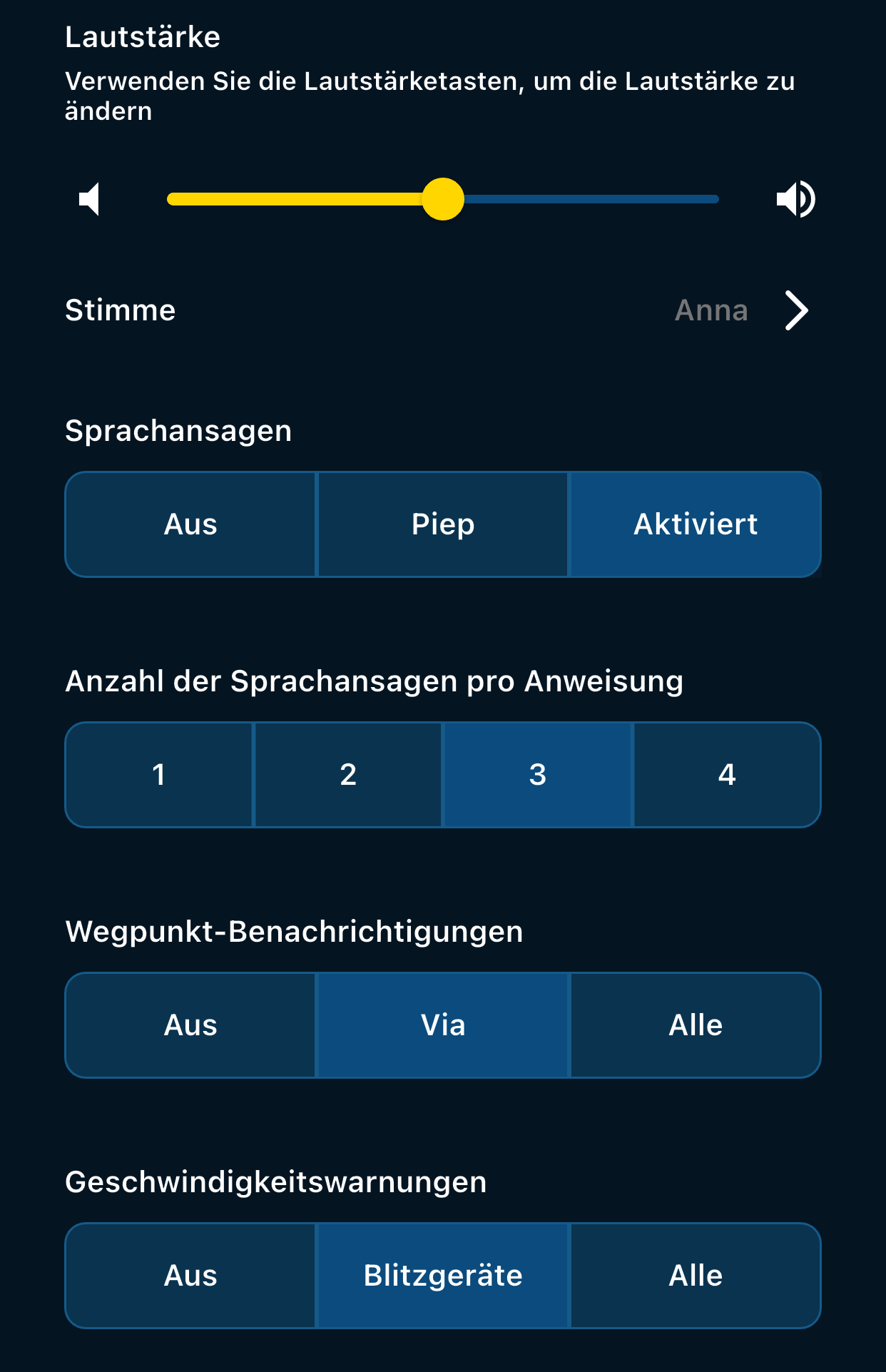

        Mopetenpit
        Mopetenpit
        Mopetenpit
        Here are my audio settings. As I mentioned earlier, I receive some announcements, but not all of them. It may not be a pure MRA issue, but rather a problem with the iPhone or something in the Sena environment.
        I'm finding it difficult to troubleshoot...

          @Mopetenpit the settings seem Wright to me zo uit must be something in the settings of your phone. Since I don't know much about iPhone I can't help you there

                  Still it can be the position of the waypoints. You said you used two different phone on two diffent motorcycles with two different headsets. Enough variables
                  MRA is not always that accurate with the actual position and the position onscreen. This can differs between phones at the same time. This can also causes loss of announcements if waypoints are close before crossings.
                  But. I also see. your announcements are set on "Via only". I've no knowledge what effect on the background this settings has on other waypoints. You cannot hear them but maybe they are still procesed and can therefore still causes issues.
