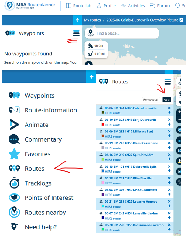

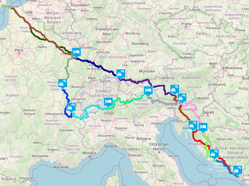

        What you can do if your after a nice graphical depiction of your whole tour is use the Add Routes feature in the web planner to create overviews like this
        Just create a new route & call it something like Overview Route - it needs to contain only one waypoint or at least one Point of Interest only so that it will be stored/saved as a functioning route on the MRA server
        Then just add each day via the Add Route feature & you end up withan overview like above
