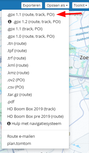

          Please keep in mind that the gpx 1.2 format is not an official format! It is made by MRA to add some extra features whch is not included in the official 1.1 format. So, best is to use the gpx 1.1 format since this is the official format. Read here more about the gpx 1.1 format: https://www.topografix.com/gpx.asp
          You can save your route as a 1.1 format gpx file includin routte, track and POI.
          Travellexxie stevemoriarty.co.za 2 Replies Last reply

            @Nomko-Nomden where did I write, that the 1.2 is an official gpx format? I just mentioned it, because TS mentioned, that he wanted to navigate on tracks with waypoints between start and finish and already downloaded 1.2. And that is exactly what the 1.2 export does for the Garmin Zumo's (that's why I asked what his last device was). And therefore it is, in my opnion, the finest choice for my XT.
