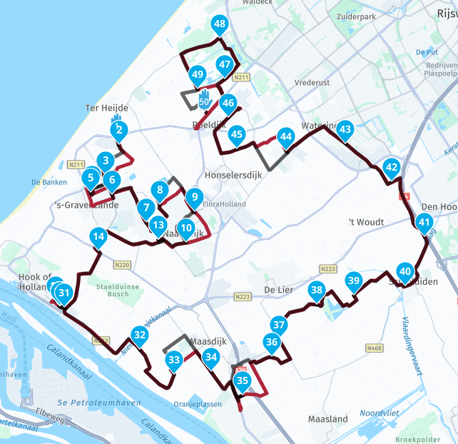

              original tracklog in red overlayed with the created route in black
              appears to me, as Jan suggests, not enough points were used in the generation of the route & hence the routing algorithm was able to calculate alternate paths between points

                @Brian-McG Meh, you surely are right that adding more WP can solve this issue, yet, I'd like to point out that the auto placement of WP is simply not perfect as one can clearly see in this picture. Before increasing the amount of WP, I would first dive in and move some WP a bit to force the decision making of the algorithm a bit more to follow the tracklog.
                Examples to move the wp to the red cross:
                wp35:
                wp33:
                wp6,8, 9:
                wp3:
                Please note that the auto-increase amount of waypoints can definitely cause new cases of these 'misplaced' waypoints, so one shall check those as well. Before going that route, (HAH! You see what I did there ^-^?), one is better off cleaning up the auto converted route first, rather than immediately increasing # of wp. 😄

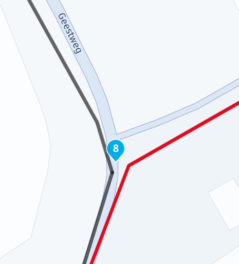

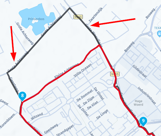

                    Tussen routepunt 8 en 9 heb je 2 wegen die je kan volgen. De track (in rood) pakt de eerste de beste weg na punt 8 terwijl de route een straat verder ligt. En dan is er nog iets met routepunt 8: Deze ligt aardig op de T-splitsing waardoor MRA niet goed weet of snapt of je of rechtdoor wilt de Geestweg op of rechtsaf wil slaan.
                    Ik heb het zelf beetje aangepast op deze kruising (onderste screenshot) en na elke afslag een routepunt geplaatst (in mijn voorbeeld nu routepunt 9 en 10). Daarmee "dwing" je MRA en de route om die weg te volgen.
