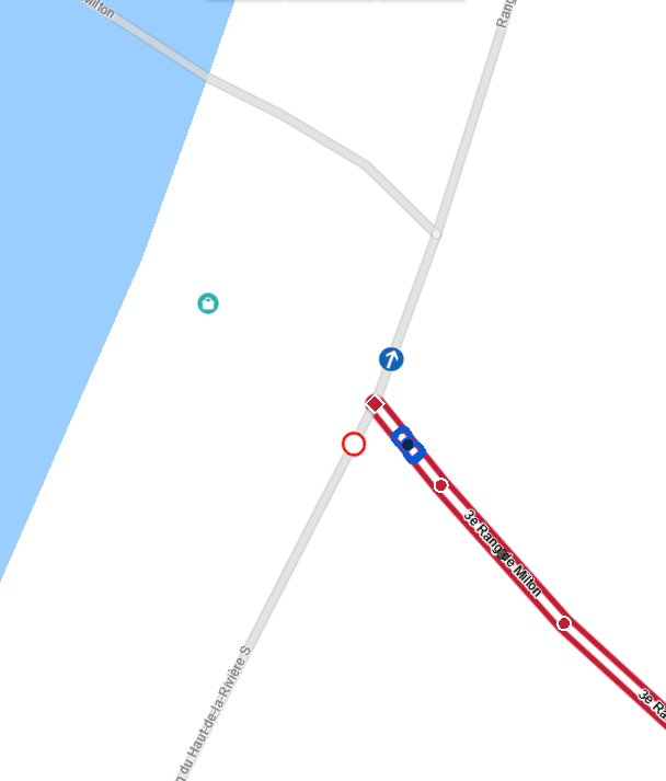

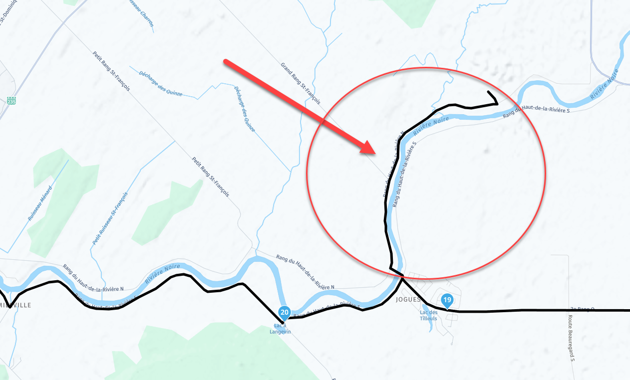

    I got some weird thing appear when i plan some of my maps, and despite how many waypoint i added to avoid this.. it's still there.. it create a little ryde into a dead-end.. so we need to do a U-Turn..
    So, as i share those map with other, i know that bug and took the right turn.. but other will follow my shared map.. and will be confused (or upset) about why i sent them there....
    Here the shared map : https://www.myrouteapp.com/fr/social/route/11470838?mode=share

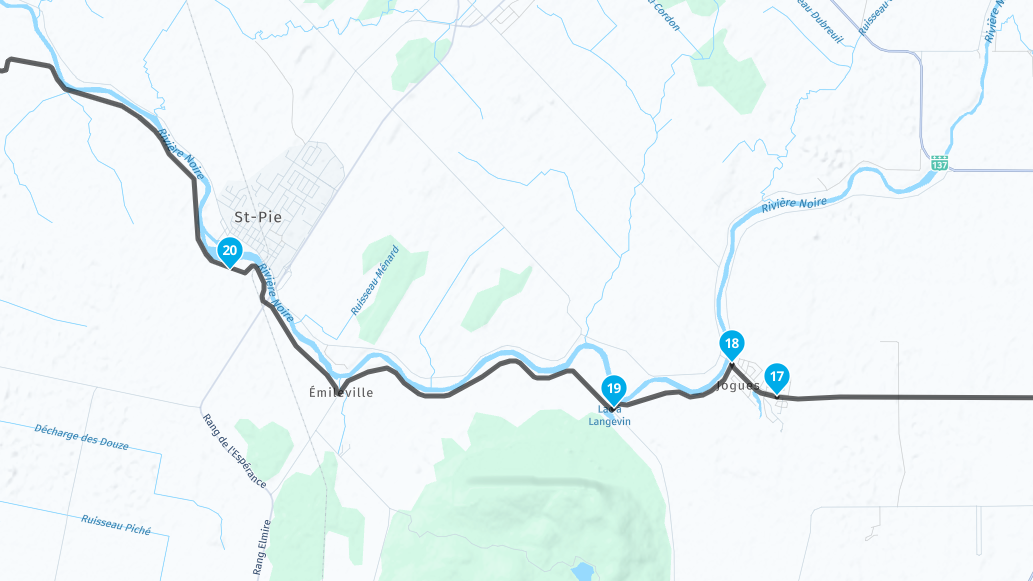

    • it's between poit # 19 and # 20
    • originaly, i create a stop at # 18, and the the point 20.

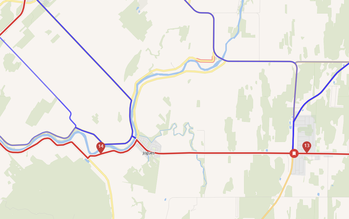

    • in other software i used before for doing my ryde, but i stop using it because lack of Android Auto support, here how it was configure there
    • is was using "HERE!" for this. When i try "TomTom" and "OpenStreetMap", and the weird "sent to dead-end" diseaper.
    • So, if i want to avoid closed road, i need Here .. but "Here" create those issues, so i select TomTom or OpenStreetMap.. but those 2 will not show me traffic and closed road
    • you can see that i only need to set point # 13.. and point # 14.. and the line is correct.
    • it's not doing the weird move to a dead-end
    The way i temporary fix it, is to create a new way point "as near as possible" to this intersection (now called Waypoint 20 - Don't go There"... (it's in the shared link i create)
    So.. if i want "HERE" to be used.. is there a way to add "something" there to avoid this weird "send to deadend" (Detour)

        @Banshees, exactly where you placed WP18 the detour get's shortened to the a few meters, this will be visible once navigating. Dunno, must be some map fault about not being abled to turn left at the crossing. But I don't see that in streetview. Adding WP 18 does what you want, doesn't it?

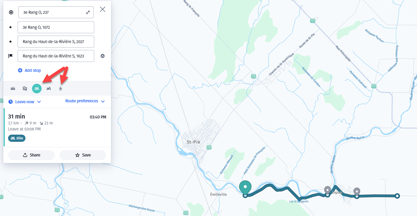

            I open a ticket with support... and got a very fast response ! awesome.
            So as i share my map, i then add a warning before that error, and tell on the warning (in both Language in Quebec, Canada) : tourner à gauche - Turn Left.
            But they also sent me the HERE link (and they report to them the issues), where i can signal an error on their map (like this one). They
            I also open an account on HERE, to see how it doing.. and it's the same 🙂
            • if yo uselect "bicycle" or "walking".. it's show the proper path
            • if you select CAR or Motorcycle.. it's doing the weird thing...
