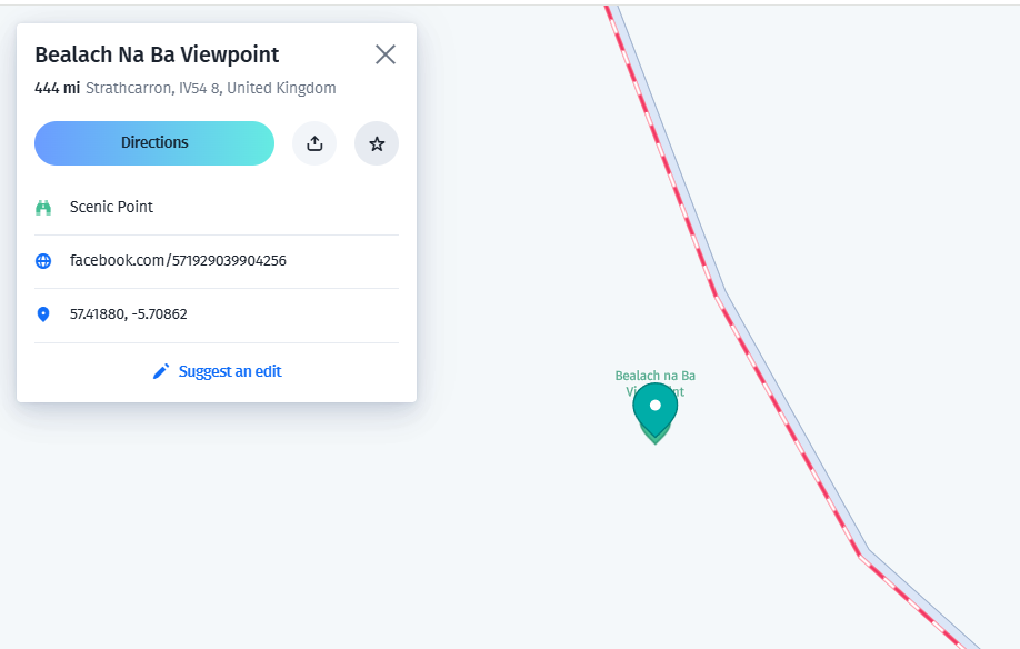

        • Nick Carthew
          The route planner from HERE called HERE WeGo is showing the Applecross Pass as closed in one direction.
          I have reported this to HERE as being incorrect. I'm not sure how long it will take for them to update their map.
          richtea999 1 Reply Last reply

                @big-vern
                Thanks Nick, yeah I stumbled on that just before and signed up, after checking on one of the NC500 forums to check it was indeed open both ways, which it is as someone had been over it on Monday.
                Thinking of some workaround to force the app to ignore it, I noticed on foot on the here map it seems to be ok
                edits
                I guess I could revert to a tomtom map and do it as a track but even then after checking it comes up with route violations on the IOS app, I guess because its doing the track on what it thinks is a one way road. Plus I loose all the waypoint info.
                Its good to know its the backend map thats at fault I suppose, but I do wonder why the online route planner and the IOS app are not in synch in terms of the issue

                  @Nick-Carthew Great work Nick, seems to have sorted it thanks very much!
                  I couldn't see a link for reporting so thank you!.
                  These forums always solve the issue for me quickly so thanks again everyone as well who responded.

                    @big-vern Wow. Never know HERE to fix an error that quickly before, maybe they think I have influence πŸ˜…
