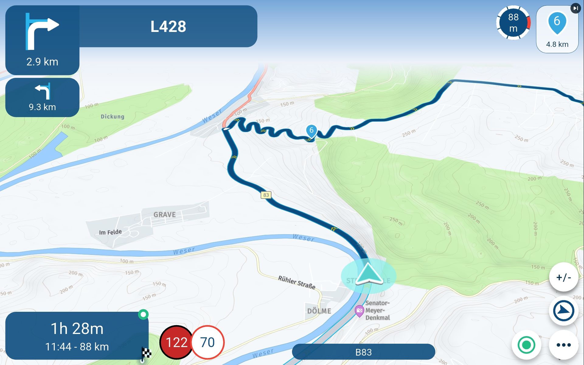

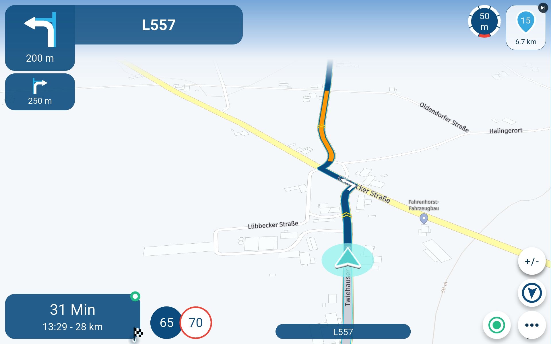

                  The orange route sections are meant to indicate traffic disruptions, aren’t they?
                  During my recent journeys, I’ve seen this marking on various roads, even though there was either very little traffic or not a single vehicle there apart from mine.
                  There were no roadworks that were inactive.
                  And despite having the option to take traffic disruptions into account enabled, the route wasn’t automatically changed. That would have been a bit silly, too.
                  Is there perhaps another explanation for this oranje colour – maybe it has something to do with nationalism? :-))
                  Is there another explanation?

                    @RainerT The traffic information is not instantly updated, maybe when you are travelling at 122 in a 70 you have arrived before the traffic was there 😁
                    M. Schrijver 1 Reply Last reply

                      OK, I had to press two buttons on the tablet at the same time to take the screenshot – that sort of thing can happen. But in the screenshot above, I wasn’t going too fast.
