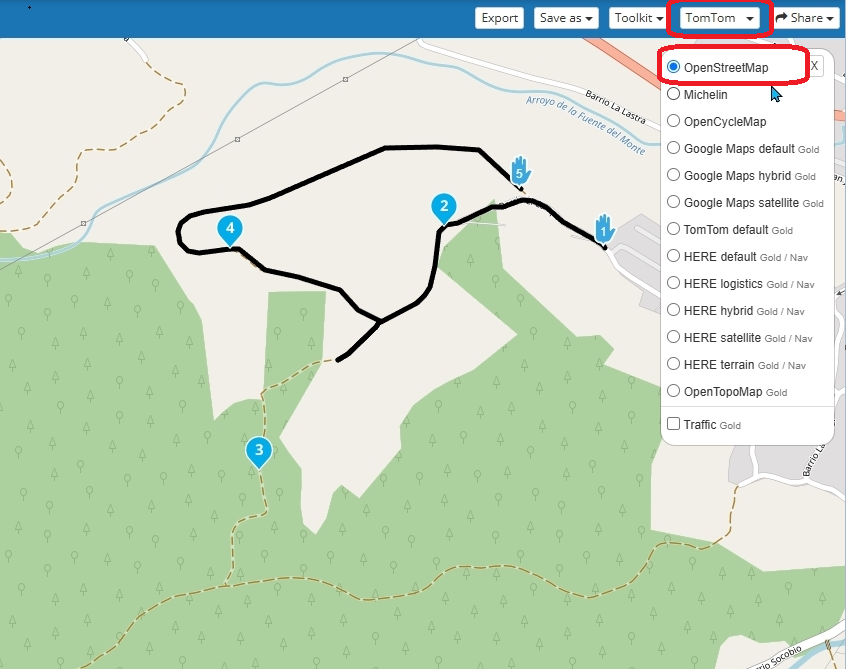

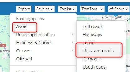

      @derek-c
      Do you have unmarked this option?
      Staszek
        Explicit preference of gravel roads is not supported.
        Best would be to plan in OSM as they have more gravel roads mapped and then convert the route to TomTom.
        derek c 1 Reply Last reply

          Thanks for the speedy reply much appreciated i’m new to all this route planning what is this OSM is it another app related to my route app if not, can I download it to the MyRoute-app to view it and change it if necessary? app?@Corjan-Meijerink
          Corjan Meijerink Hans van de Ven MR.MRA 2 Replies Last reply
          • derek c derek c
            @derek-c Oh sorry, just select OpenStreetMap where it says "TomTom" in the screenshot above. This will allow you to use that map which quite often includes more offroad roads.
