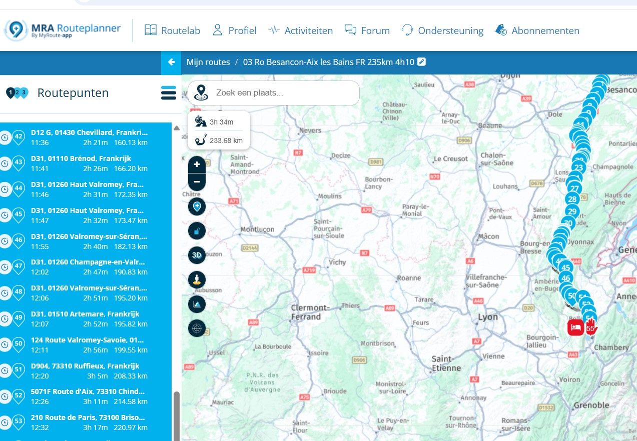

          Is this route by any chance marked as an offroad route in the online routeplanner? @Herman-Veldhuizen
          Offroad routes are not (yet) supported and can indeed give weird results! I am investigating the possibility to support this ๐Ÿ™‚

              @Herman-Veldhuizen can you share the link to the route? Make sure itโ€™s public ๐Ÿ™‚

                @Corjan-Meijerink https://www.myrouteapp.com/route/open/9785664

                  @Herman-Veldhuizen yes, itโ€™s marked as offroad.
                  The app does not support this.
                  I am investigating if we can!
                  Open the route in the website, click toolkit and uncheck โ€œoffroadโ€.

                    @Corjan-Meijerink @Corjan-Meijerink Thanks for looking into it. It works now.
                    This is the first time I have seen the toolkit so one could wonder why this setting was on. Maybe I added a waypoint in the middle of nowhere at some time in the past without realizing it?

                      @Herman-Veldhuizen glad I could help!
                      The setting is really only accessible on the website so you must have visited that ๐Ÿ˜‰
                      If using the website, best to just use a computer and visit myrouteapp.com.
                      The app works great but the website itself through the app / on a mobile device is suboptimal ๐Ÿ™‚

                          @M-Schrijver when navigating an offroad road as track, the original track data is used. However, as the entire route is marked as offroad, there is no track data. The track data is just straight lines between all waypoints ๐Ÿ˜‰
                          The app does calculate a nice route to the nearest point on the track. Therefore you get a correct route to a point on the track and then just straight lines as the offroad route has no information.
