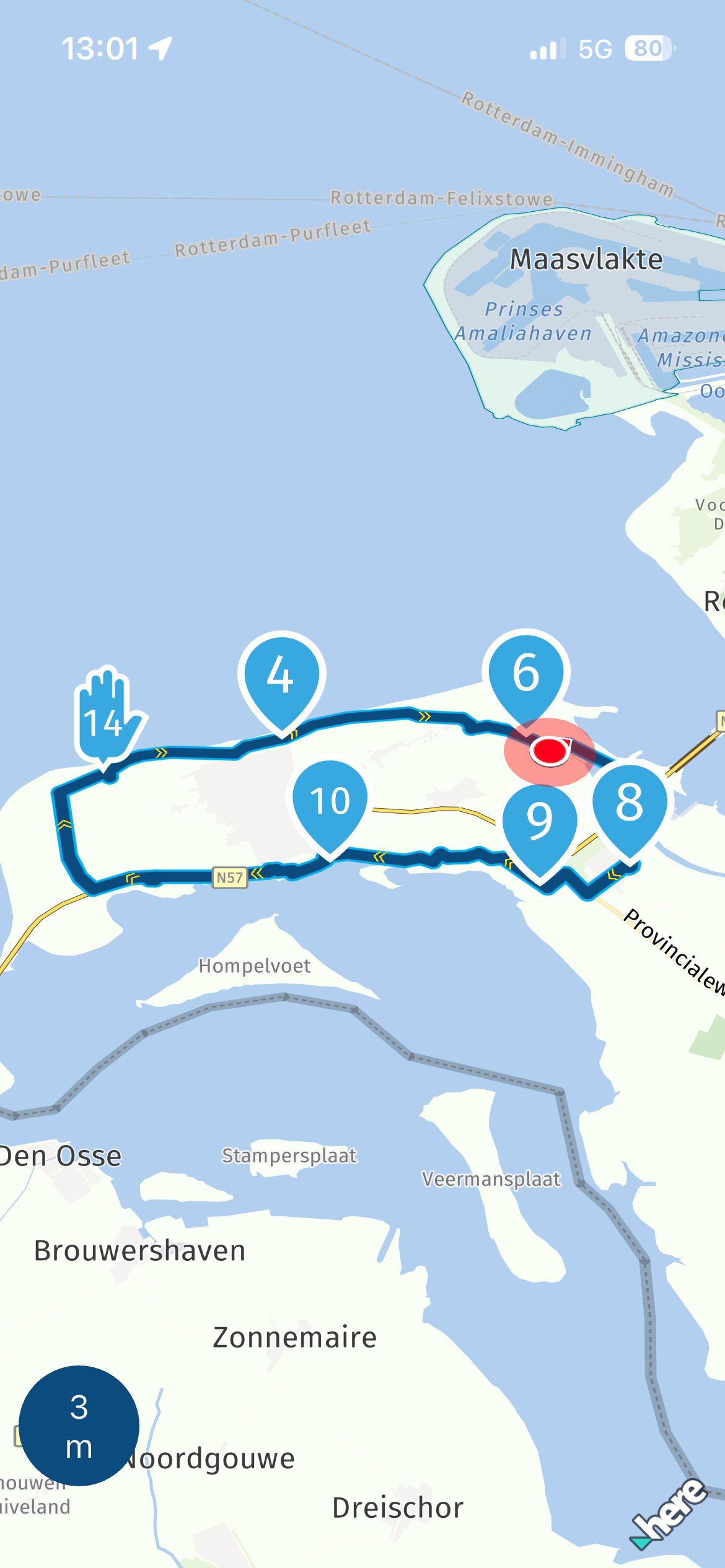

                      Today i did a tour again. Waypoint Messages set to all.
                      Today it went pretty good. There were some small things but a lot better than yesterday.
                      This shows a problem also. Still a lack of stability. Some days goes well and other days are problematic. This should be more or less the same every day. The software must be reliable, predictable.

                            What i think what happens.
                            When driving you have a certain speed. But the accuracy of the GPS varies. Therefore every navigation tries to predict what are going to do. You see this behaviour when entering and exit long tunnels.
                            I think the disapperance of the blue line is also a part of this prediction (sort of).

                              @M-Schrijver correct 🙂
