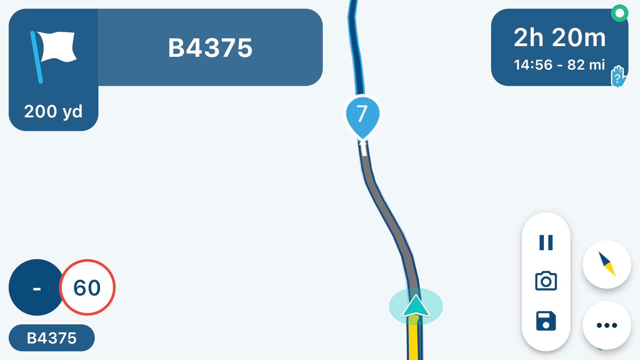

    Just took a short ride using new beta version (3.2.7 - 149.) iPhone 11P iOS.16.3.
    I have just updated firmware on the phone as well, it might be a source of the issue?!
    The route is short with some shaping points and one via.
    I have started the route away from the Start point. The application correctly guided me to the Start point. After I reached the start point, at the bottom of the screen where you select the time to shapingpoint, viapoint, and the endpoint, the time was shown to the endpoint all the time and the icon displayed the question mark on the blue background for all points.
    To the viapoint:
    To the shapingpoint:
    To the endpoint:
    When I approached the viapoint, the color of the viapoint was correct on the map, but still something was still not right on the bottom of the display. Even though the viapoint was selected, the time was displayed to the endpoint of the route.
    I have stopped at the viapoint and stopped the navigation. When I restarted the navigation, the time and icons at the bottom displayed correctly the numbers and colors. The time to the shapingpoint and the endpoint were displayed correctly. When I went to the setup and disabled audio for Shapingpoints, everything returned to the fault condition, the time was displayed to the endpoint and the icons were displaying question marks.
    In addition, the switches that disable the audio for Shapingpoint and Viapoints do not work. Even if the both are in the off position, the announcements for ALL the points are still audible.
    The voice announcements are still shaky and cut off. What I heard during the ride when approaching waypoints with nothing else in the neighborhood (roads, turns, intersections...):
    "You have..."
    "You have reached..."
    "You will reach waypoint..."
    "... in 600yards"
    etc.
    I do not know what happened at the end of the route. The location icon was still moving correctly, but the map display changed to the North-up by itself?!
    This is the first time I have notice the flag icon in the top-left corner. Something new. 🙂

      I had the same problem, the blue viapoint (hand) had a question remark all the time and I just saw the km's but without "km" after the digit. I your picture is "mi" presented but I didn't see "km" today?
      sometimes I sas also the end flag (left on top) in the middle of a route point and didn't have the next turning point that you can see below the flag.

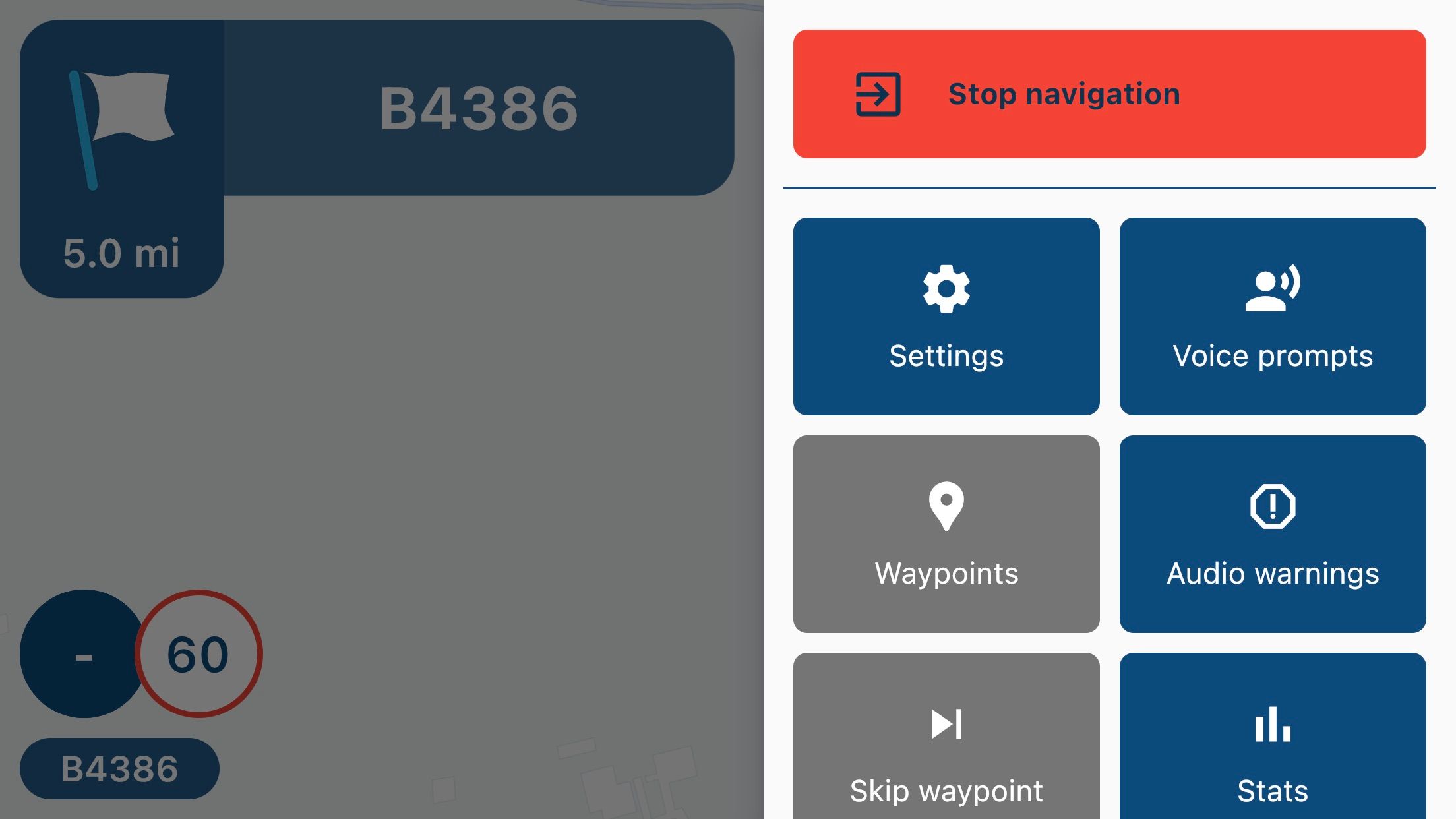

              @Corjan-Meijerink I have had the same problem testing today. I notice that I cannot skip waypoints as when the flag shows, there is no central icon and the menu to skip waypoints is greyed out. Like the others, I had the selection for audio shaping points deselected but the points kept announcing even though they were shaping points as shown on the map.

                Thanks for sharing! My initial conclusion is that something is wrong in identifying the waypoints. Hence the fallback image (flag) in the top left and the question mark in the ETA widget. As they are not correctly marked as waypoints, the voice prompts will also be announced.
                That's probably a good thing as fixing one issue will solve them all 😉
                Could you by any chance share the route where this error occurred? Please make sure it's public.
