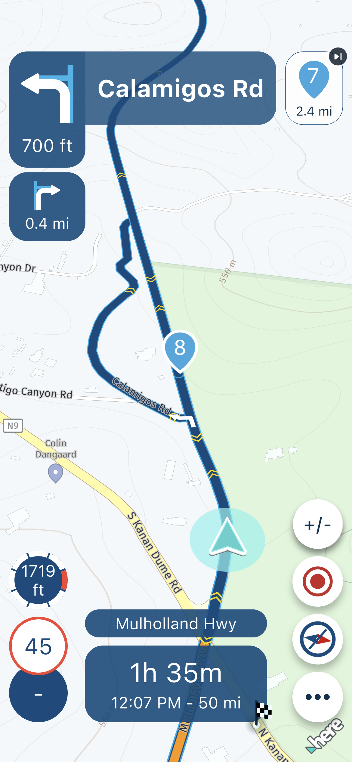

        Some screenshots below from my iPad Pro.
        Open the route directly in the Routes folder not the Routelab.
        For me it shows the pop up in the top right corner on my iPad Pro where I can select Garmin Drive.
        artboneundefined 1 Reply Last reply
