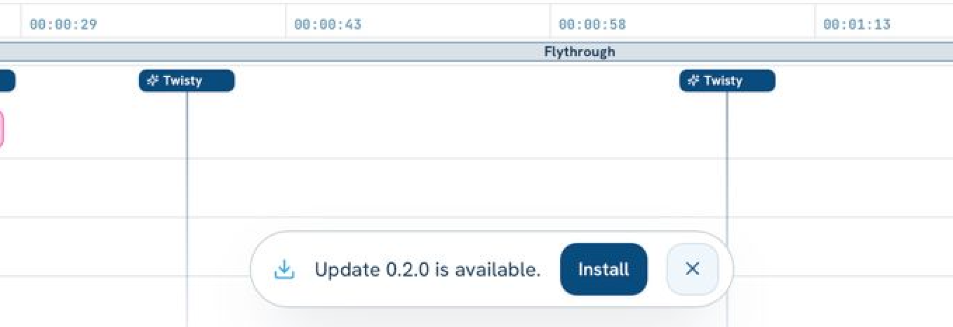

                            I believe there is, but hidden in plain sight at the bottom of the screen when Studio is open 😉
                              No, there was nothing.
                              Anyway I did the update and can confirm that Version 0.2.0 works much faster and the mouse does not have any influence. 👍
