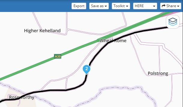

    Hi there,
    Suddenly out of the blue, a route that i regularly take with Myrouteapp has changed.
    On a section it diverts me off the main road and on to a dirt track for 1/4 of a mile and then back onto the main road again?
    I haven't changed any of the settings, it seems to effect Car/ Motorhome, Motorcycle but not Truck.
    The Yellow indicated is the correct route that it usually takes.
    This used to happen to me when using Copilot, hence why I stopped using it, does anyone know if there has been an update that may have caused this?

      @Next-Stop if you select the traffic layer on the web planner you might see that there's an obstruction over there. That could cause the diversion

        Thanks for the suggestion, although there doesn't seem to be any hold ups. I have just tried using OSM rather the Here and OSM gives the correct route. So must be something to do with them 😞

          @Next-Stop If you add an additional route point on Roseworthy Hill the HERE map will use that road.

            @Next-Stop Another possibility is the change in Route Optimization from Shortest to Fastest! If you do that on this particular section of road, you’ll see a change in your route. I don’t see any roadworks in the HERE map layer either.
