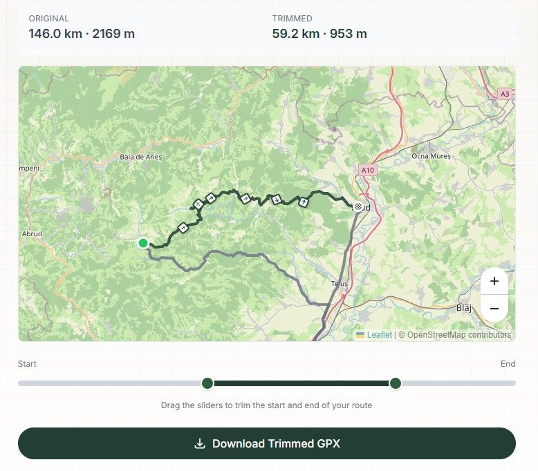

            • Adrian Avram
              wrote last edited by Adrian Avram
              You cannot create a track, but you can split it or trim it and you can join multiple tracks, and just save as a new track !
              https://www.therideatlas.com/tools/gpx-editor/
              Adrian
