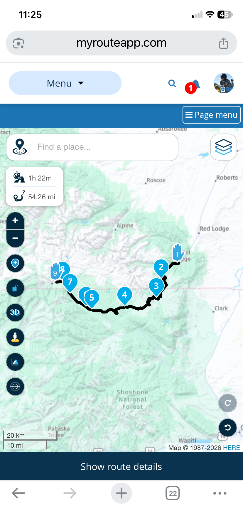

          Nick Carthew Offline
          @Stevedo-6-0
          I was able to route on the Beartooth Highway without using the Disable seasonal closure tool, I just added some extra route points.

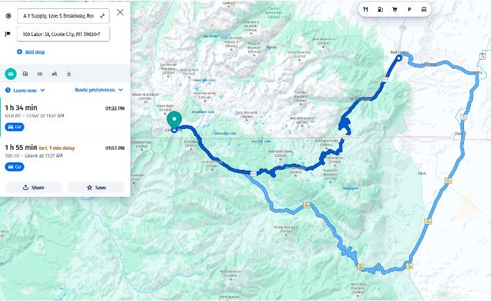

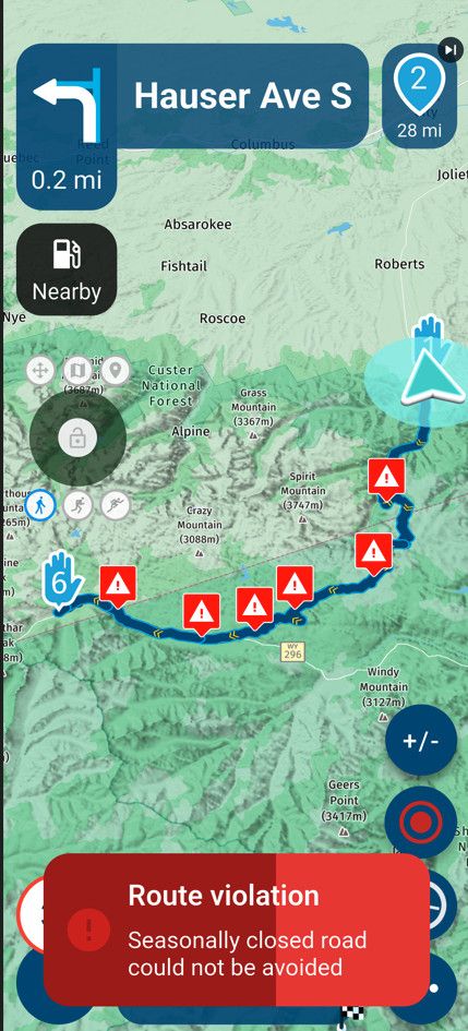

            Brian McG Offline
            Brian McG Offline
            @Stevedo-6-0 said: I assume that this is a HERE maps issue.
            Use the "Compare" tool & you will see that TomTom & OpenStreetMap route without a problem
            I would then go to Google maps & simply try to route from Red Lodge to Cooke City
            If Google, TomTom & OpenStreetMap say its passable, then you can be pretty confident you are correct in saying yet again the Here map data is bad
            In this case the Here map data seems to only be bad / out of date for MRA as the HereWeGo site seems to route through with no issue

              LennyO Offline
              LennyO Offline
              wrote last edited by LennyO
              @Nick-Carthew Nick, that's interesting...
              As soon as I saw the post come out, I tried to create the same route and it would not let me. I started adding waypoints and found 2 spots where it wanted to create a bypass. (WP6-WP7 and WP8-WP9)
              One of the roads to be used as a bypass was seen as blocked by the gate on Street View (WP8-WP9).
              I did not disable seasonal closures, of course and no avoidances selected.
              I also searched the Internet and was not able to find any closures posted anywhere.
              TomTom and OSM Navigate straight thru the bypasses on HERE.
              https://www.myrouteapp.com/route/open/14020487
              So, I wonder what made you able to do ut without a problem...???
              You must have this thing in total submission to you! 🤕
              I noticed that you did your route on the phone, so I thought hmmm... maybe that's where it is somehow different. So, I just tried my phone and encountered the same issue as on the Route Planner.

                Brian McG Offline
                Brian McG Offline
                Hi @Lenny-O it is not magic, it is just old / out of date map data
                I think the Here map data that MRA is using for this road still has its winter setting, so it set as closed
                if you try to route along this road it will always try & look for an alternative that is not set as closed
                at your points WP6-WP7 and WP8-WP9 there are alternatives, even if they are not practical because of gates etc, & the Here routing opts for the alternative that is not closed rather than the closed road
                you can make it route along the closed road between WP6-WP7 and WP8-WP9 just by adding additional points
