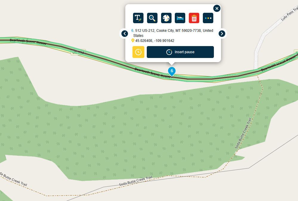

@Nick-Carthew Nick, that's interesting...
As soon as I saw the post come out, I tried to create the same route and it would not let me. I started adding waypoints and found 2 spots where it wanted to create a bypass. (WP6-WP7 and WP8-WP9)
One of the roads to be used as a bypass was seen as blocked by the gate on Street View (WP8-WP9).
I did not disable seasonal closures, of course and no avoidances selected.
I also searched the Internet and was not able to find any closures posted anywhere.TomTom and OSM Navigate straight thru the bypasses on HERE.

I noticed that you did your route on the phone, so I thought hmmm... maybe that's where it is somehow different. So, I just tried my phone and encountered the same issue as on the Route Planner.

Hi @Lenny-O it is not magic, it is just old / out of date map data
I think the Here map data that MRA is using for this road still has its winter setting, so it set as closedif you try to route along this road it will always try & look for an alternative that is not set as closed
at your points WP6-WP7 and WP8-WP9 there are alternatives, even if they are not practical because of gates etc, & the Here routing opts for the alternative that is not closed rather than the closed roadyou can make it route along the closed road between WP6-WP7 and WP8-WP9 just by adding additional points
