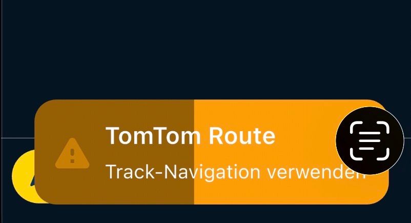

            @gianluca-0
            wondering which setting you have used during your route planning? Standard or TomTom or HERE?

                    @gianluca-0
                    What @leike-lodiers writes is very important and should definitely be taken into account.
                    The route is planned in TomTom algorithms, the window s. Image comes when starting the navigation on my mobile phone, so it leads to the fact that it is actively navigated as a route track, traffic data is also missing.
                    Please switch to Here algorithm, then it will be navigated correctly.
                    And please do not let the route navigate over such a long distance, divide it into 3-4 sections.
                    From experience, I would basically divide such a long route. I think on 3-4 sections especially in the mountains 300km a day is enough.

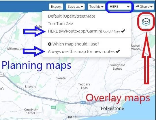

                          @Gianluca-0
                          It is important to use the correct planning map for your navigation device.
                          Each planning map comes with its own set of algorithms embedded within the map data to calculate which roads to use.
                          The algorithms are unique to each planning map.
                          So if you use MRA Navigation Next you should use the HERE planning map.
                          After choosing the HERE planning map you can also click Always use this map for new routes to set the HERE map as your default planning map.
                          From now on all new routes will be created using the HERE planning map.
                          My screenshot below shows the planning map from HERE is selected and also the option to Always use this map for new routes.
                          The overlay maps are separate to the planning maps and have no effect on route calculations.
                          Think of them as clear sheets with extra information that you place over the top of the planning map.
                          The planning map underneath does all of the route calculations.
                          So with the HERE planning map selected you can then use any of the overlay maps.
                          If you do not see the same blue menu bar with the planning maps that is shown in my screenshot, click Page menu first and then all of the same options will be available to you.
