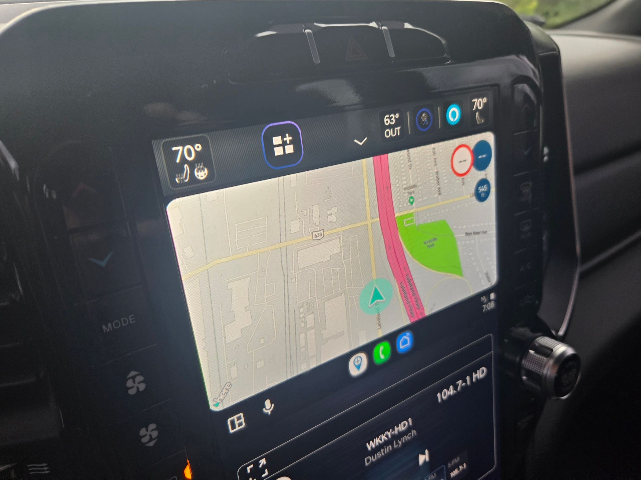

    Hello all, did the upgrade, re logged back in and started driving. First thing I notices is I lost the speed indicator up in the corner of the screen. Still there, just displays "0" all the time! Android phone, Galaxy S26.....20260523_190817.jpg
      Your pic is crashing the app

        what do you mean my pic is crashing app?

          @D-Griffin is I try to open it, my app stands still
          • D Griffinundefined D Griffin
            @D-Griffin but now it does 't
            It seems like your device is not receiving any gps data
