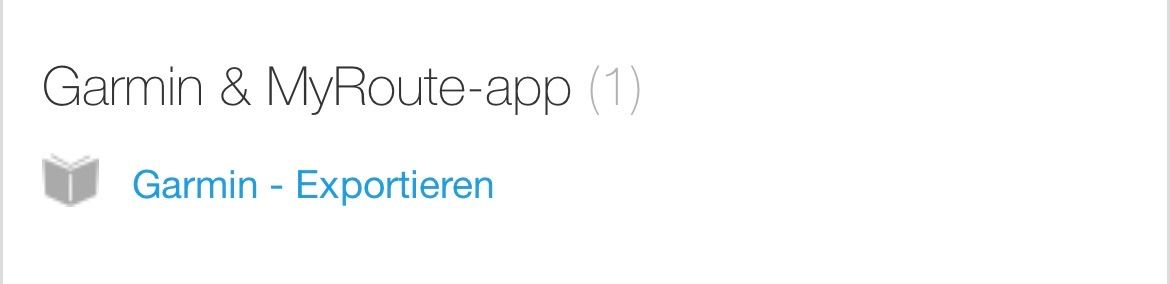

        Create the export in 1.1GPX format and then transfer it to the XT2... maybe it will help to display the route better.
        Otherwise, read the MRA manual
        Link to Manual
