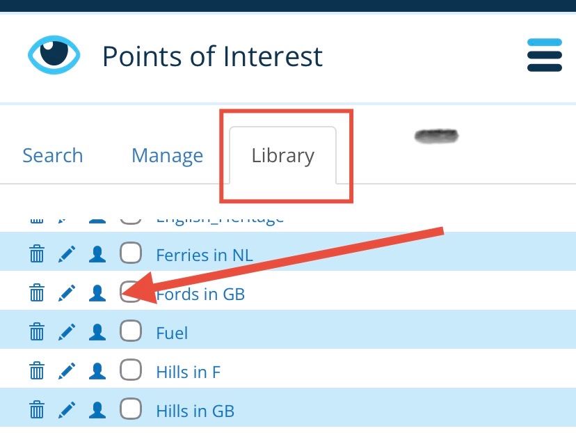

      @Lary Favourites are like bookmarks and are used to find favourite locations quickly, use the big + icon to add a favourite as a waypoint.
      POIs. If you have a list of POIs that you have uploaded to your personal POIs library, selecting the account icon for a list will show that list in all routes and they will be visible on the MRA Navigation Next app while navigating.

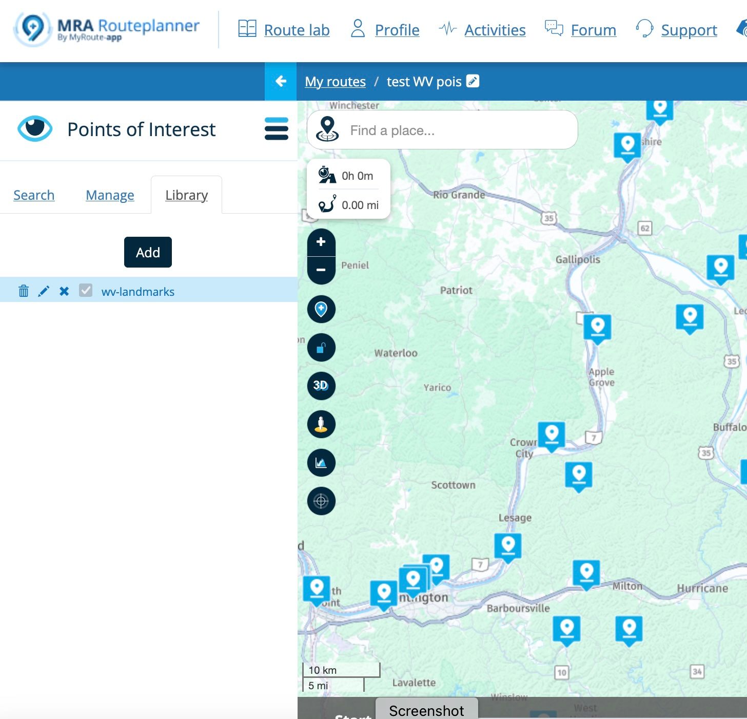

        Hi Nick, thanks I've made some progress. I was able to upload a file of POIs (West Virginia) to the library and they do appear in new routes as you said. I have a lot to learn on this process as the whole file appears under one POI. I assume because it has no organization. Is there a link where I can learn more about managing POIs than in the support manual topic? (I don't see the little person you point to).
        Is there a way to get the POIs we've adding to a route into the library or to download them into a file and re-upload them so they are available in all new routes? Thanks Lary
        • Lary Lary
          @Lary The ‘little man’ or account icon is under the X in your screenshot, you have already clicked on it. After clicking, it turns into a X, click the X to turn them off.
          You can save POIs from a route by clicking Save as and choose the .csv option, then upload it to your POI library.
