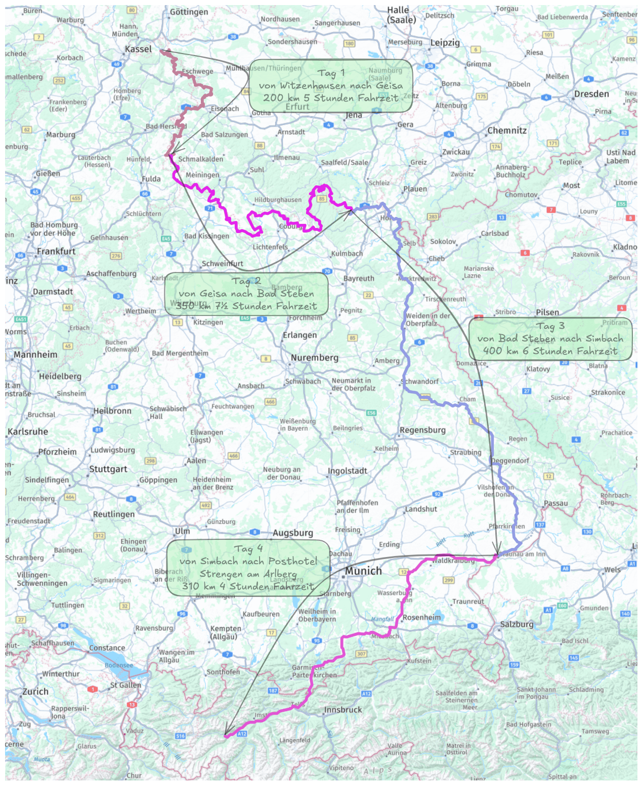

          For my summer trip, I used the Iron Curtain routes as a basis. On the road, I use MRA Navigation on a waterproof Samsung active.tab.
          It’s not comparable to your distances, but there are certainly more bends 🙂
          RT
          Gesamte Iron Curtain Strecke von Witzenhausen nach Posthotel Strengen in Arlberg.png
