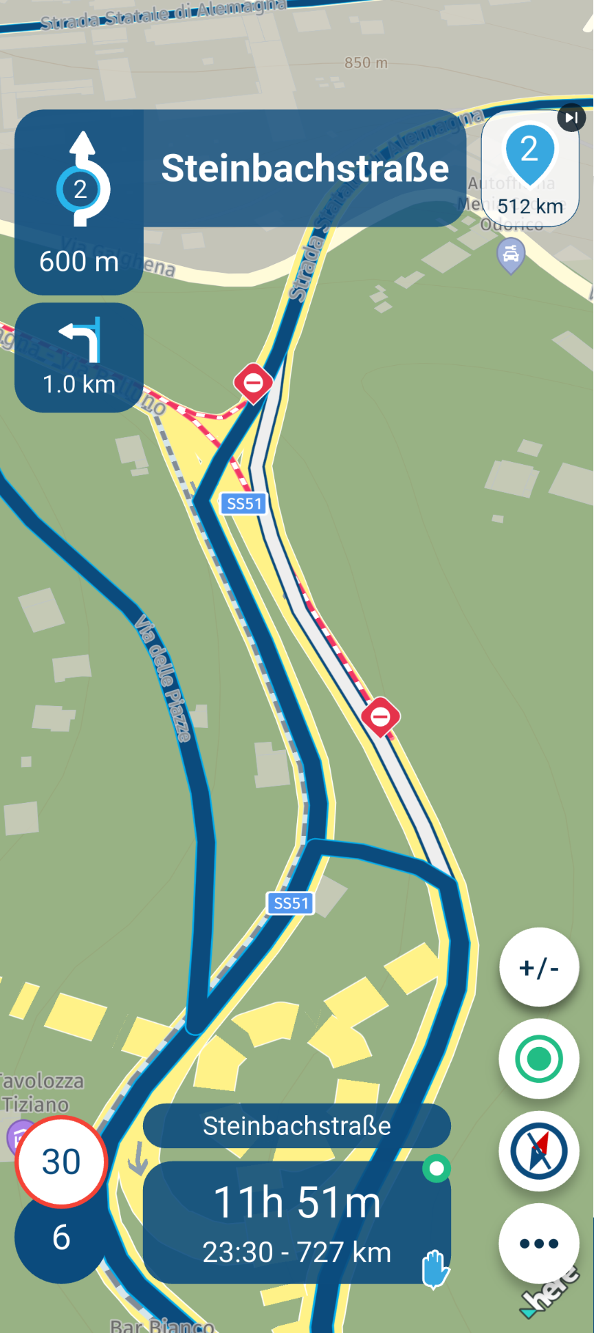

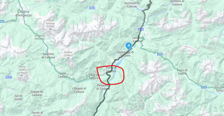

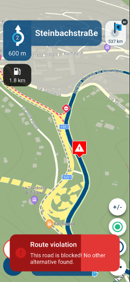

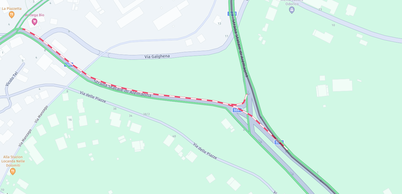

          @Con-Hennekens said in App behaviour when in offline mode at a construction site:
          You can also simply disable all traffic options in your settings - functional tab if you don't want that info.

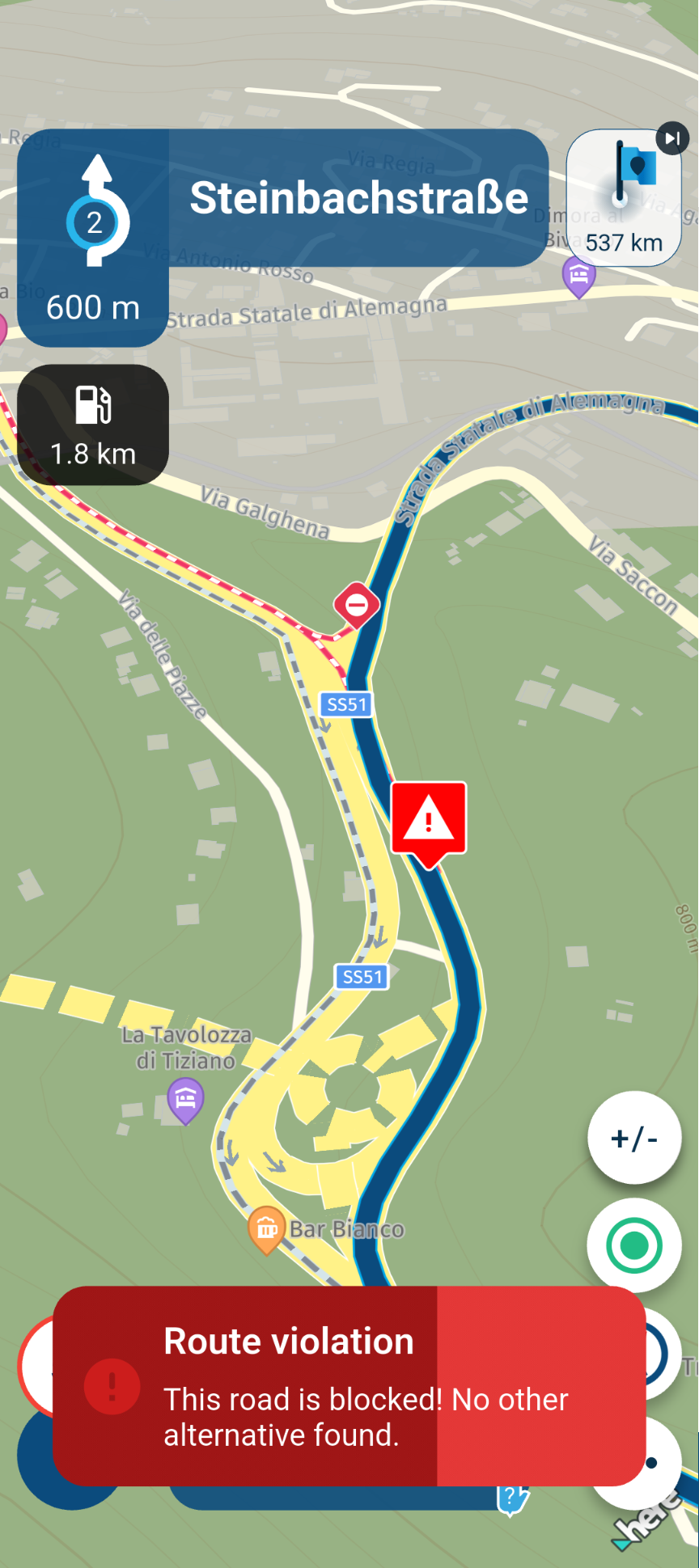

          Hi Con, I’m not sure if this setting will solve my problem?
          A week ago on Sunday, I wanted to drive this route, but the problem started at the spot I’ve marked in red: the app refused to let me continue, or rather, kept telling me to turn back because the route was supposedly closed.
          Ultimately, according to the app’s instructions, I was supposed to drive via Cortina d’Ampezzo, even though the roadworks had already finished.
          I’ve just disabled all traffic settings in the app and started the route; the closure still appears on the map, and I don’t think the app will ignore the closure at that point because of that.
          It may well be that I no longer receive any information, but the route through the roadworks will still be blocked.
          I am therefore looking for a practical solution to this problem.
          https://www.myrouteapp.com/de/social/route/13124967?mode=share
          Screenshot 2026-04-23 100413.png Screenshot 2026-04-23 100320.png [link text](link url)

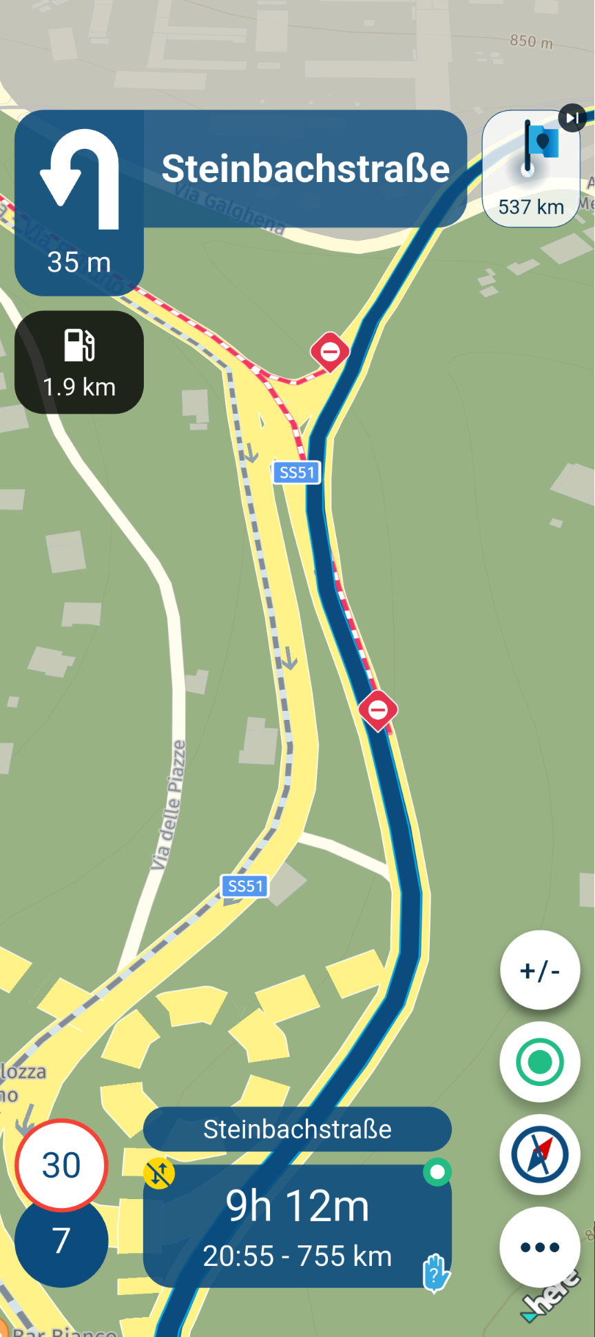

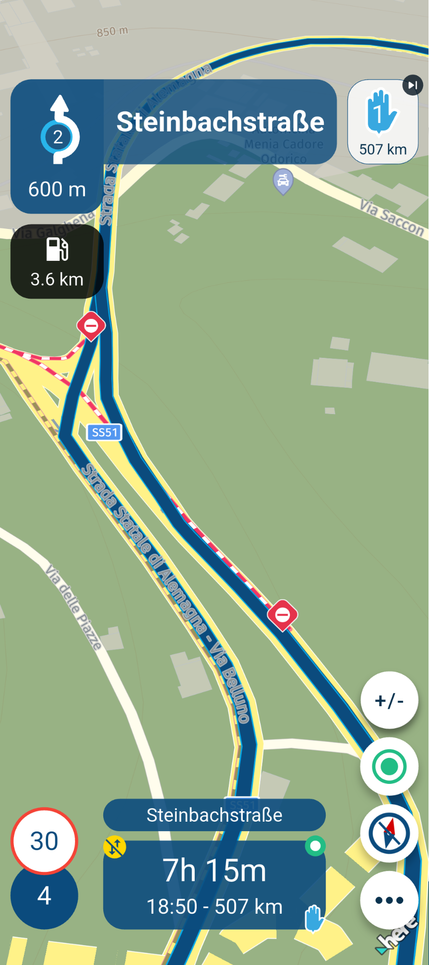

                • MotoCon MotoCon
                  @Peter-Zehentreiter, yep
                  #26
                  @Con-Hennekens I’ve updated the maps; I think it’s now version 2.18.
                  The glitch was practically gone by last week.
                  Attached are 4 screenshots…
                  1x Route with online traffic information enabled
                  1x Route with offline traffic information disabled
                  1x Track with online traffic information enabled
                  1x Track with offline traffic information disabled
                  offline Route as Route Traffic settings off.png online Route as Route Traffic settings on.png Route as Track online Traffic settings on.png Route as Track Traffic settings off.png
                  BMcG 1 Reply Last reply

                      #28
                      Hi @Peter-Zehentreiter is the shared route "Marostica_Lienz" just an example to illustrate the issue or is this the route you plan to use?
                      This error maybe because for this route the avoidance "Highways" is enabled
                      the aviodance maybe limiting the options that the routing calculation can use when trying to recalculate around the construction
                      Peter Zehentreiter 1 Reply Last reply
