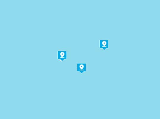

    I can't get the POIs displayed from a self-made POI file.
    I generated a CSV file like this:
    51.225800,6.615499,"Am Schulzentrum Kaarst","Forum"
    Longitude, Latitude, “POI Name”, “Description (optional)”
    Made sure that all information is separated by a comma.
    I can import the file in MRA, choose a symbol, and when activated, nothing is displayed.
    What is wrong?

              @Jörgen, Found it!
              You need to swap lat/lon 😉
              The POI actually do import, on the other side of the globe... 😉
              (actually they don't, they are not valid coordinates)
              Try this:
              6.615499,51.225800,"Am Schulzentrum Kaarst","Forum"

                Hi Con, you're a genius—how did you figure that out?
                I never would have guessed that.
                Why “Latitude, Longitude” in MRA?
                That's a bug in MRA, right?
                Google uses that format too—“Longitude, Latitude”
                By the way, my POIs where in the Arabian Sea, just off the coast of Somalia.
                I would never have found that.

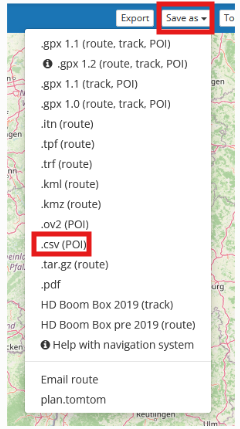

                              @Jörgen if you had saved/exported a POI from MRA yopu could have inspected the file to get the format
                              @Con-Hennekens CSV is the standard format for POI even MRA uses it to export 😉
                                @Brian-McG, MRA uses GPX too. My point is that fields in a CSV have no designation. In GPX (which is XML) they do.
