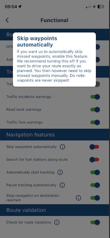

    Please help me to understand. I know the difference between shaping and via points and how they work, e.g., on a Garmin and not working differently for a TomTom.
    I have been told that there is also a difference for Navigation Next.
    But I did not notice any difference in NN.
    What is the difference? Something to do with how waypoints will be automatically skipped?

      @Jörgen Via points will not be skipped automatically if you have set Automatically skip waypoints.
      Also, notes for via points are read aloud at 2km but shaping point notes are read aloud at 750m.
      Jörgen 1 Reply Last reply
        @Nick-Carthew said in Shaping points and Via points:
        Hi, thanks. I will try this, respectively I will try is again.

                          @BertM You can get the ETA info for viapoints (hand icon) or for both viapoints and shaping points (droplet icon). How you navigate a route (route or route as track) makes currently no difference.
                          If you use shaping points for your possible stops they will eventually be skipped (still annoying to be sent back to the ones you missed and you will unfortunately also see the ETA for points which you added for the sole purpose to shape the route).
                          If you use via points for your possible stops then you can filter out the shaping points but the via points will never be skipped.

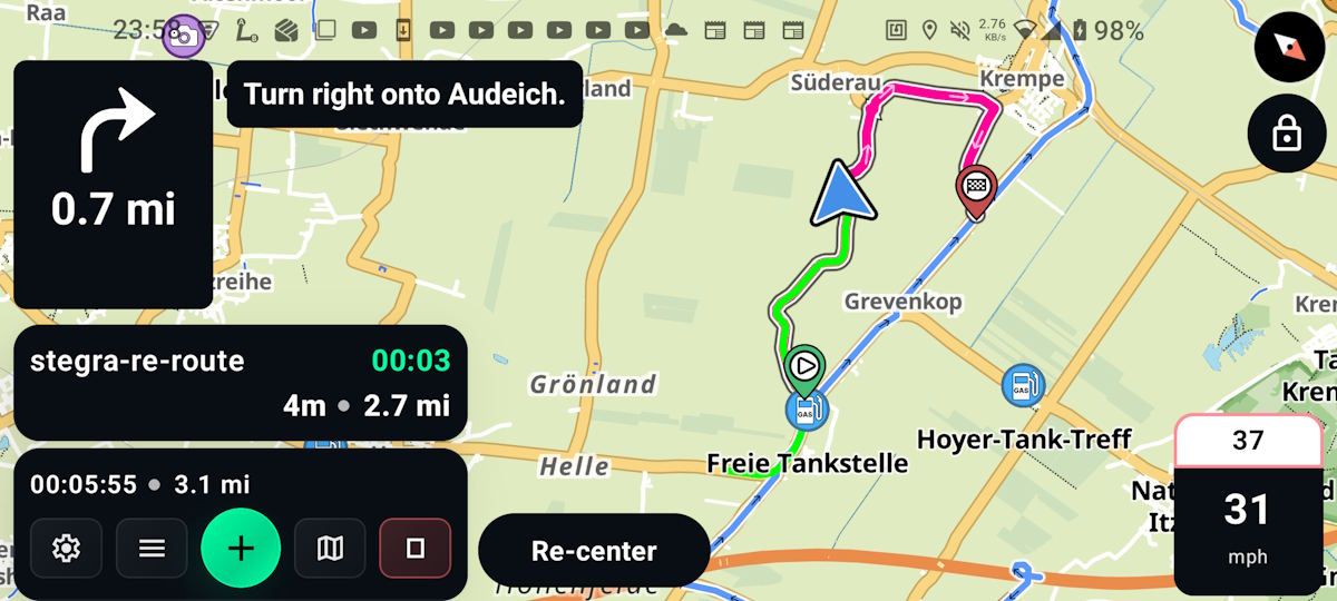

                                @Martin-Wilcke Unfortunately this is not what I observe. I wish it did and i believe it worked like that for a short while when route as track was added.
                                ETA info to my (optional) waypoints are important for me. So I have never considered pure track navigation.
                                When I navigate my route as track the app DOES use the way points in my route to navigate. I suppose it tries to find a logical reentry point but it also sends me back to a waypoint. How many times it tries to send me back to a shaping point seems to depend on how far the next point is.

                                          When navigating "Routes as tracks", all waypoints (SPs and VIAs) should be skipped automatically, as this is how track navigation works.
                                          That is a bit strange, since the one-and-only function of a VIA point is that it cannot be skipped automatically 😉 . How track navigation works is without any route points at all.
                                          @Con-Hennekens In this topic (https://forum.myrouteapp.com/topic/9552/waypoint-skipping.-mra-vs-beeline) I made a test route in both MRA and Beeline. Both have bikers as their target audience. The behaviour of the apps are however very different when it comes to skipping points. I dont think that Beelines behaviour is odd.
