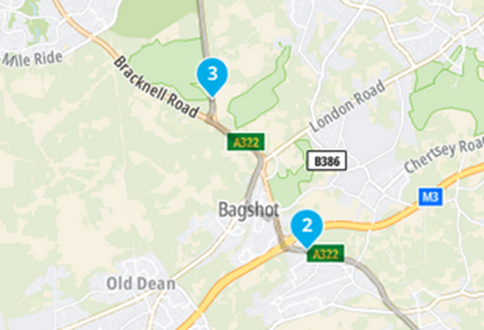

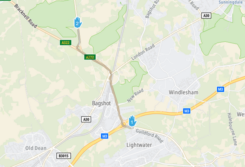

    Hi
    Can anyone see what is going on here?
    I noticed in my route "Dunstable" that between points 2 and 3 that the route came off the dual carriage way to take me through Bagshot twon centre.
    When I tried to isolate the problem it disappeared, routing as expected, but I can't work out why
    The routes both use Tom Tom mapping
    Links to the two route files below
    https://www.myrouteapp.com/en/social/route/12873336?mode=share
    https://www.myrouteapp.com/en/social/route/3564294?mode=share
    thanks
    Tony

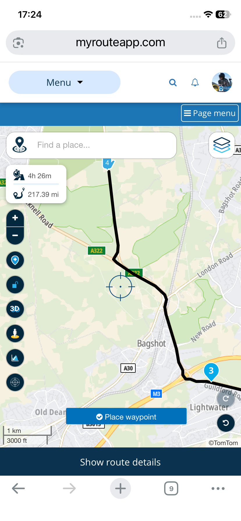

        @Tony-13
        I can’t replicate the diversion using any of the 3 planning maps. I suspect that either stationary traffic or a road closure forced the temporary diversion. My screenshot shows me using the TomTom map.
        In your Dunstable route you have low Hilliness and curves selected and average Curves selected. This is why your route goes via Bagshot.
        • Tony 13
          Tony 13
          Tony 13
          Thanks Nick
          must have first done this route a long time ago, i don't usually touch the curvy road setting. It's result is a bit random as this route shows.
