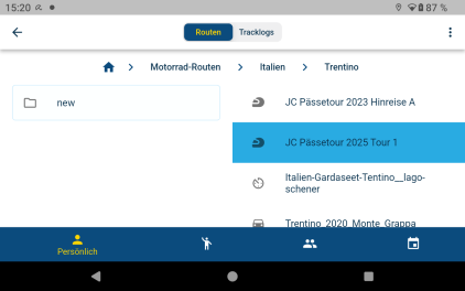

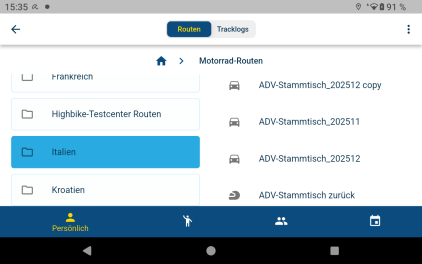

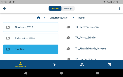

    I can access by remote controoler my route library and can navigate arround:

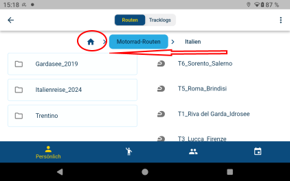

    But if I need to step back/up in the folders, I can reach the top breadcrumb menu. But not the root folder. I can only reach the last sub folder and then the main screen/home:

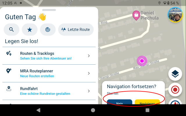

    Next example: If I want to stop a navigation, the last question, if I woul like to stop or to resume navigation - it's not possible to reach the button by remote control:

            But I feel, my question belongs to "main function". During a ride, I often want to stop navigation and restart (may with other Waypoit as starting point). It's a bit nasty with the double confirmation for stop the navigation. But if I could reach both confirmations by remote controller, I can live with.
