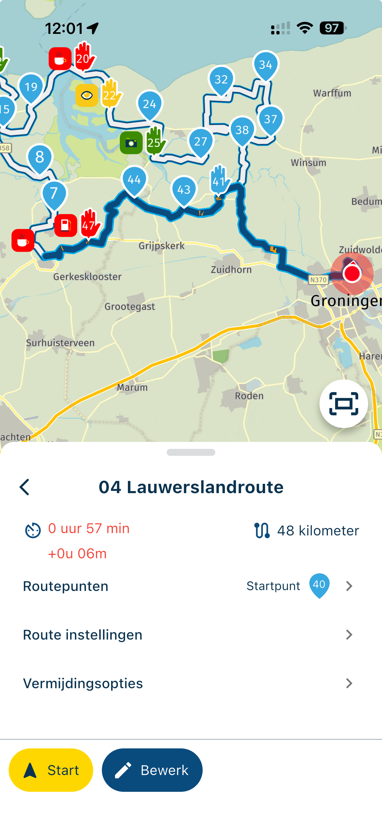

    Wouldn’t it be nice if you could change the starting point of a surrounding routeand still be able to drive the whole route?
    When I select point 41, which is the closest to my location, I don’t get the first part of the route anymore. On the PC when you change the starting point the whole route is renumberd.

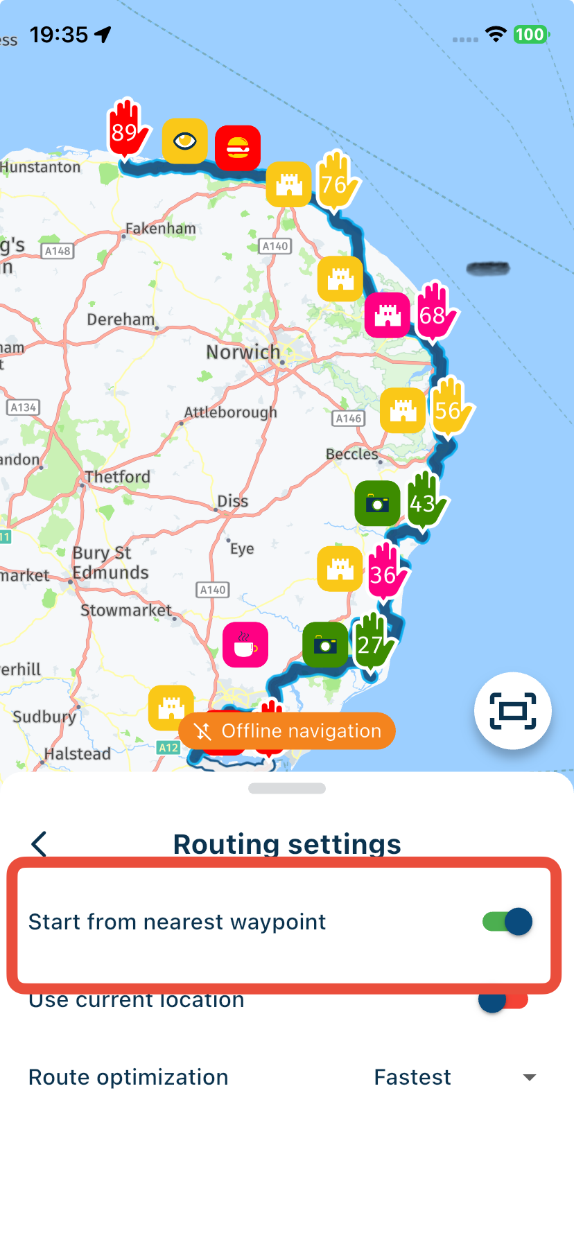

          @Rolf-Engelsman After tapping Navigate, tap Routing settings and here you can choose to start from nearest waypoint.
