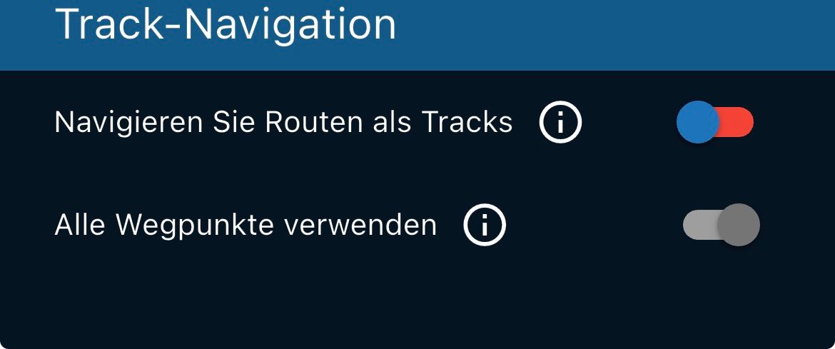

      It helps to navigate the route as a track; this can be set under Settings in your own account, then under Navigation settings / Functions at the very bottom.
        @Hubert-Thoring I do!
