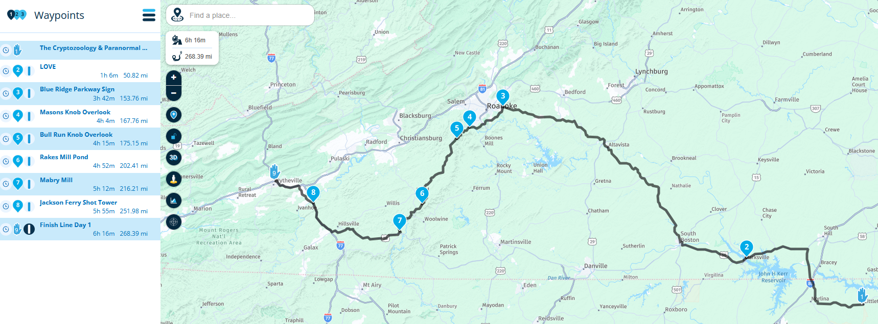

    Hi All,
    I have a GPX file that I created that right now includes a track and 9 waypoints. When I import, the track looks just fine, but the names and descriptions of the waypoints are missing. When I import the file into Osmand or OnX it looks fine. Any thoughts?
    A screenshot and the GPX file are located here.
    CLICK HERE

      What routing software did you use to create the GPX?
      I think your issue may be an unusual formatted GPX file, each track & waypoint element content in your file contains the term "ns0", ns=name space
      Unless the software you are uploading the GPX to can interpret the "ns0" term then things look like they go a bit pear shaped. Appears Osmand can cope with the term but not MRA
      As the "ns0" term is not one I am used to seeing in a GPX file I stripped it out using this xml converter & the resulting track & points loaded correctly into MRA web planner

            @Kerry-Lebel in your original post the GPX track you shared had 9 waypoints, these are clearly shown in the picture I posted with the waypoint names, it looks exactly like it does in Osmand & I was surprised to see that MRA also imported all the descriptions for the points
            Somewhere along the way your original recorded GPX file seems to have had the "ns0" attribute added to it, just use a text editor like notepad to view the GPX file & you will see "ns0" all over it.
            This could have been introduced by Garmin Explore or it may have been in some other part of the storage/transfer chain & this is why you were having issues importing it to MRA & losing the waypoint names & descriptions
            I agree recreating a route with 100 points & all the descriptions is a bit of a task & a little unrealistic
            I am not sure what you now asking for, cleaning up the GPX file seems to work well, this is a link to a cleaned up copy of your original GPX imported into MRA
            https://www.myrouteapp.com/en/social/route/12495544?mode=share

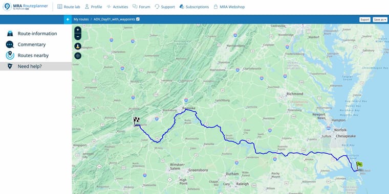

                @Brian-McG this is great thanks Brian. I removed all the NSO attributes from the tags (editor tool issue) and that cleared up the waypoints naming and description issues for me as well (thanks to you), but when I click to see tracklogs (I assume this is where it would be?) the track did not get imported.
                Based on what I understand of MRA workflow, what I am trying to achieve now is uploading the file with the track and waypoints into one route. Convert the track into a route. That gives me the shapoing points I need plus the primary waypoints for stops and photo opportunities. I would be fine uploading them as two separate files but I can't upload the waypoints into an existing route correct?

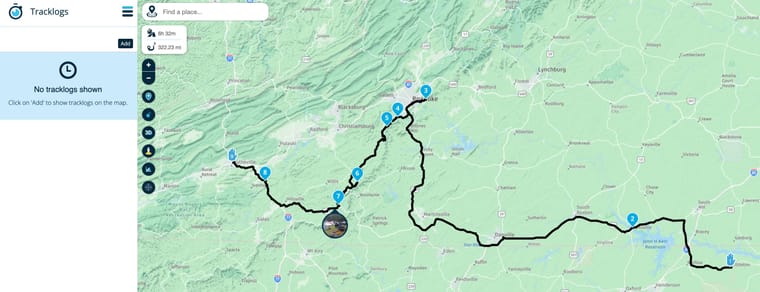

                If I try to import the file as a Route-Track, then the waypoints don't appear importing that way. I'm not sure why there are two different import methods. I do have some gpx files that have waypoints, routes and tracks all in the same file.
                Next I tried to just import the tracks by itself, convert it to a route and see if I could find a way to import those Primary 9 waypoints into this new route created from the track. No deal. It looks like you can only do an import into a new route and you can't select the location where the imported file will go to (subfolder).
                Brian McGundefined 1 Reply Last reply
                • Kerry Lebelundefined Kerry Lebel

                  Hi @Kerry-Lebel I think maybe you are over thinking things or are trying to apply possibly Garmin know-how to MRA & getting a little confused
                  This thread has a little discussion about routes, route-tracks & tracks as they apply to MRA which hopefully makes things a little clearer
                  If your aim is to generate a gpx file that contains both route, waypoint & track information all you need to to is via the MRA web planner select "Save As" in the top right corner of the page & choose the format you prefer
                  If you save the file in each of the multiple different gpx formats you can inspect them with a text editor & observe the differences
                  In general gpx 1.1 is the most versatile & readable by most navigation systems as it contains both the waypoints & track info
                  Gpx 1.2 was developed really for Garmin devices, it contains route & track points but not the Waypoint info
                  At the end of the day you select the format which works/suits your navigation device which is obviously the aim of doing all this planning 😂

                    ...a gpx file can contain:
                    • a track with dedicated trackpoints
                    • list itema route with min 2 dedicated routepoints
                    • list itemseveral Points of Interest (waypoints)
                    But the general structure in MRA is, to load (by a gpx file)
                    • a route into the folder structure for route
                    • a track into the folder structure for tracks
                    You can't mix them up! If the gpx file contains both (route and track), you need to upload it twice - one time the route into route folder structure, second time the track into track folder structure.
                    The internal upload logic of MRA picks the needed information automatically out of the gpx file. But for tracks, only 2 of the trackpoints (start- and endpoint) will be made visibly on the map. For routes, all the existing routepoints will be made visible on the map (max 200).
                    In MRA you can open the route and add to display additionally one or more tracks. But this isn't possible in the App (for navigation).
