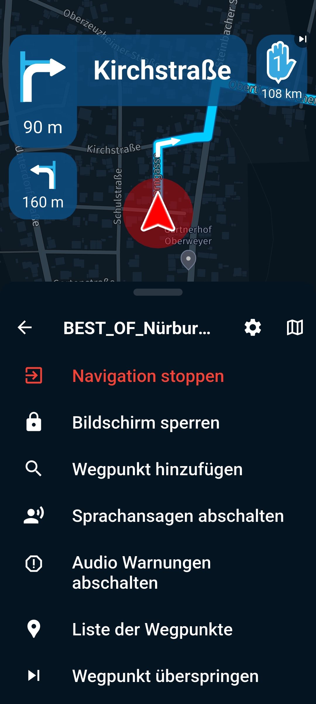

    For skip a waypoint I use upper DC (double Click) to get in the tree Point Menu (...) The first offer is stop navigation. one of the last poinst is skip waypoint![alt Screenshot_20251202_214419.jpg .
    In my case of use it will be enormous helpful to set these Point higher. In fact why I want to use it?

    To stop navigation is the last choice at a fuel station or a cafe. All others like audio mute lock screen I can do it before I start.

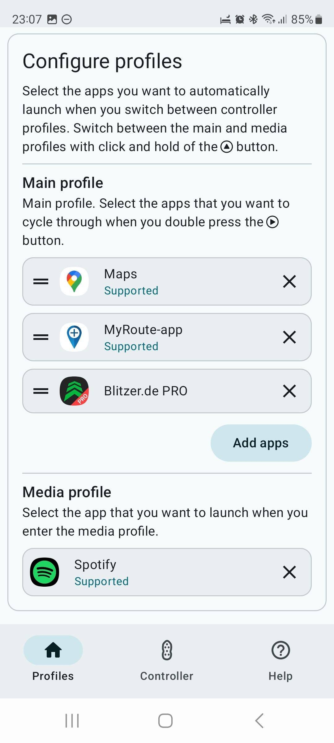

        thanks for your answer. The DC right arrow is disabled in Firmware 2.1.0 of remotek one to skip a waypoint. the DC right switch now to other apps you can define in remotek software. like Maps, Sena, Mail. It don't skip a waypoint in MRA. DC right will skip to a other app.
        In fact you got to use the menue.

          Here you can see.
          DC right you can switch to maps, Blitzer app

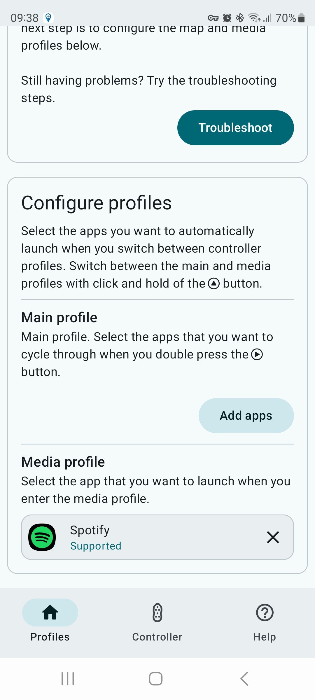

            What if you remove those other apps on the DC right? Will it then send the skip command to MRA as it should?

              Hello Corjan,
              I tested it. And YES I am now able to skip the waypoints.
              So there has no app to be in the main profile of remotek app. The Media Profile is not affected. I am able zu switch and controlling spotify app.
              If you selected MRA app it would not be able to skip waypoint
              Thanks for your help.
