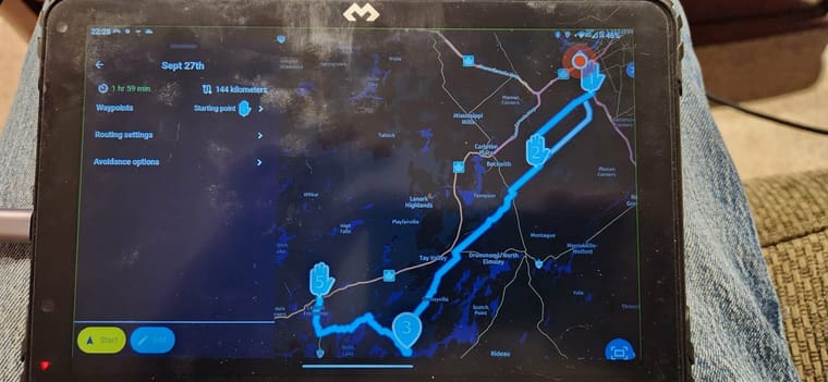

    Althought I like this new 5.0 version, it changed how you can select and start a route.
    Using my remote, I am able to navigate and choose a route like before.
    But I cannot select the "Start" button. I can navigate everywhere else, including the edit button. I need to use a touch to start it.
    Anyone having the same issue?
    Am I missing something?
    Cheers!

        Hmm, that is strange.
        As soon as you enter that screen and press “up”, what happens?

          @Corjan-Meijerink, Interesting.. As soon as I enter that screen if I press up it brings me to start. I can go back and forth between start and edit, but as soon as I go further up(waypoints, route settings etc) and come back down to the Start/Edit, the only selectable one is Edit. Got to say pressing up first thing is not very user friendly 😉
            No definitely not!
            The honest answer is that I have no clue yet why that works but just wanted to share that it works 😛
            I'll investigate the issue and work on a fix but at least you now know a workaround.

              @Corjan-Meijerink ,
              Thank you!
              Still have the App crash on bluetooth keyboard/remote disconnect/connect events btw. I did report this on my existing ticket.

                    @Corjan-Meijerink ,
                    Discovered something new for the Bluetooth issue...
                    The issue does not occur if I have 2 "input" device connected and 1 is disconnected.
                    Could you try this to confirm you are seeing the same?
                    Cheers!
                      Just edited my response. I've seen your ticket but not the actual issue itself 😉
                      Not able to reproduce it at all.
                        Both the app crash on connecting controller and this issue should be resolved in the 5.0.1 update. Please let me know when available 😃

                            Both these issues fix on 5.0.1. Thanks again!
